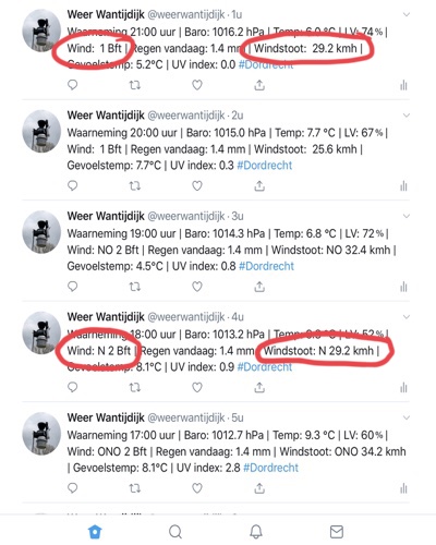

Then I noticed that my hourly tweets stopped mentioning wind directions whenever the wind blew between ZW till the NW? All my other stations like the display MBpro and my weather website had no problem with that minus correction and showed correct wind directions.

Screendump timeline Twitter with and without wind dir.

Thanks for pointing to this. You are right, a negative offset is not supported for wind direction.
