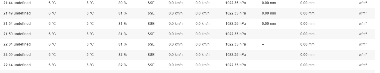

I am sending data from my Davis Vanrage Pro2, by using the Envoy and a Nano SD, to WU.
Since yesterday I have a strange rain visualization in the new WU dash board, this appears at 21:59 CET.
Till this time the value for rain Precio. Rate was shown as 0.00mm, which I assume is correct 😊
After this time stamp the value which is shown is --.
Rain new dash_20190506.PNG (19.96 KiB) Viewed 1177 times
Does someone know what the issue is?
Can this be related to the Nano data transfer to WU? And if yes, what has change?

Seems that By rebooting the Nano, I was able to fix the issue.
On the other hand I do not understand why this could happen.
