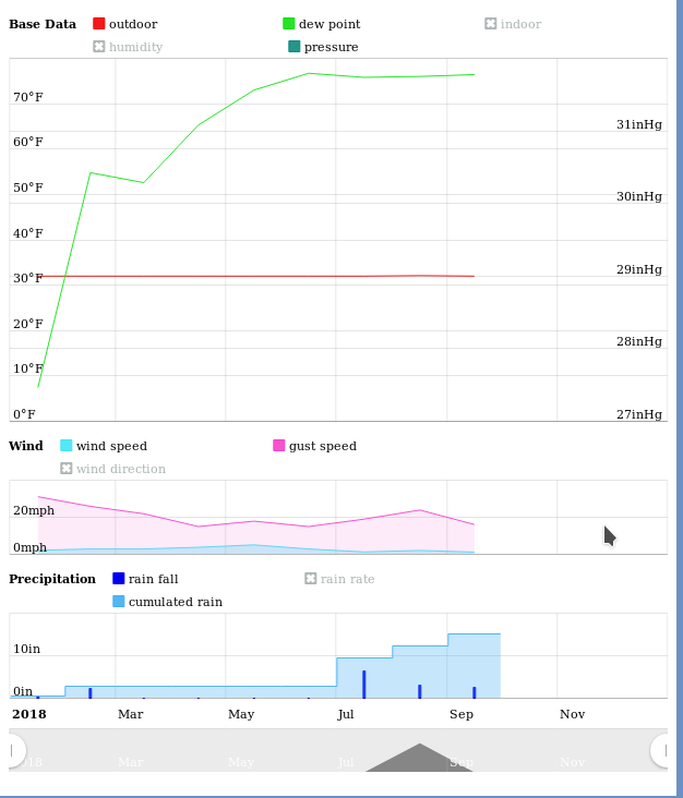

Here is the graph showing that temperature was imported wrong...
Its not 32F all year long in Texas. Not now, not later, not ever.... LOL

Re: nano sd import of meteohub data
I released a new version, please give it a try.
