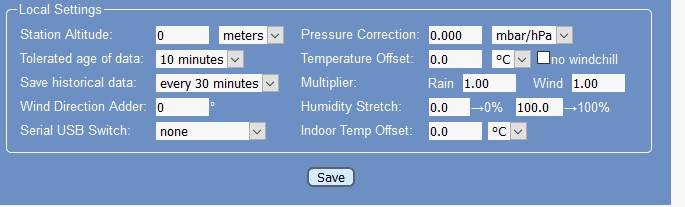

I have set everything to zero as shown here and still have a 6mb difference between the two sensors
The only thing I haven't done is reset the elevation setting on my davis console - would that have an impact
Graham

With respect I think you are missing the point of the thread . My problem is why two sensors on the same device show a difference of 6mb which is way more than any elevations settings would account for. The difference between the tbh0press and tbh0seapress is correct for my elevation - its the 6mb difference between tbh0press and tbh9press that is the problem
Graham
Re: Clarification on Meteobridge Pro and Davis Console sensors
Calibrate the th0press on "Station" tab to your liking and you are fine. Sensors do differ, no way around this and this is the reason for being able to calibrate. I have no influence on BMP180 data accuracy and don't do individual adjustments as the user can do easily to exactly fit their reference pressure source.
