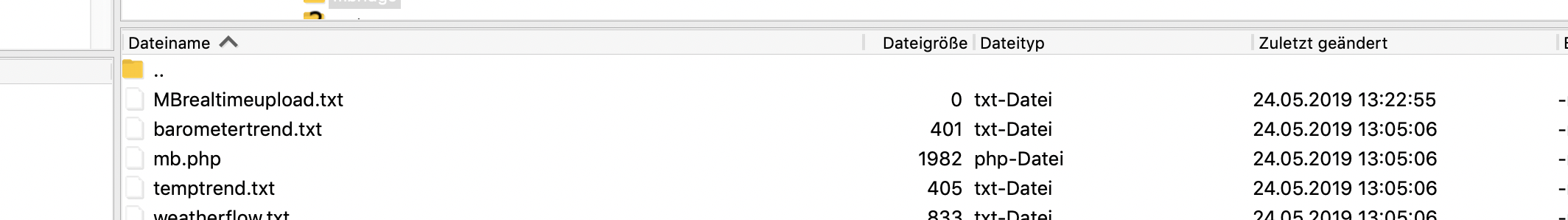

Today I noticed that nothing is uploaded anymore.
I've already restarted everyone, but without success.
The MBrealtimeupload. txt also has no content anymore.
What's wrong with this?
https://www.wetterbrienz.ch/MB/
Bildschirmfoto 2019-05-24 um 13.23.04.png (217.63 KiB) Viewed 3591 times

Did you made any changes?
Can you hit the test button and see if executes properly? What are the logs telling you?
How about the Live tab? Does the live tab tell you successful?
Are you using the local dashboard or remote?

Only uploaded the latest version. But it left this morning.
When I call the file https://www.wetterbrienz.ch/MB/mbridge/mb.php I get an error message.
But I have access to the database.
Where can I find the log files?
Re: Problems with Homeweatherstation Template
it has been fixed just reboot the meteobridge.. basically some newer values were added to the api output yesterday,but there was a slight typo error causing the blank file.im sure in a few days william fully implement these values and probably much more in the future.
today I have handed everything to William .so from this day on all changes,issues,enhancements are done via william not me anymore.
github download now resides here .https://github.com/lightmaster/Meteobri ... 4-Template
william is also now using a NANOSD so he has full access to any scenarios in general.
please do support him.. brian(aka weather34)

Okay, it's working again. Uploaded yesterday's backup.
Merci for the help. . . .
