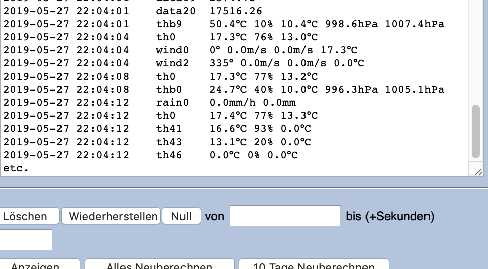

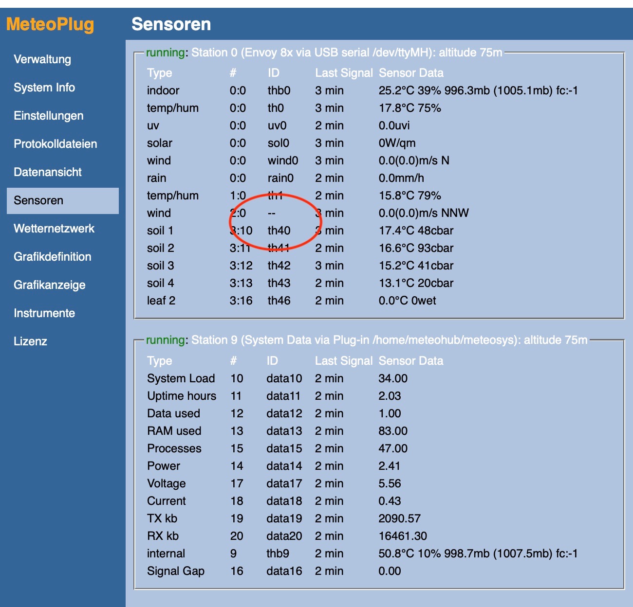

I set up my Davis Vantage Pro 2 with an Meteobridge PRO with one ISS on ID#1 and an additional wind sensor linked to a wireless transmitter station on ID#2. Meteobridge sends the data to Meteoplug, where I produce a window to put in my webcam picture.
My problem is, that the additional wind sensor "wind2" doesn't get an ID, just "--". See attachment 2.
If I look into the Data (inspect data) I see both sensors wind0 and wind 2 (wind2 is the right one, wind0 is the ISS WITHOUT a linked wind sensor) - see attachment 1.
Why is there no ID? I can't use wind2 in the charts definition, when it has no ID.
In former times I used a Meteohub system (Awekas Box) and then it worked fine.
Can I eliminate the original wind sensor in Meteobridge or Meteoplug, so that there is just one wind sensor (wind2)?
Thank you for ideas!
