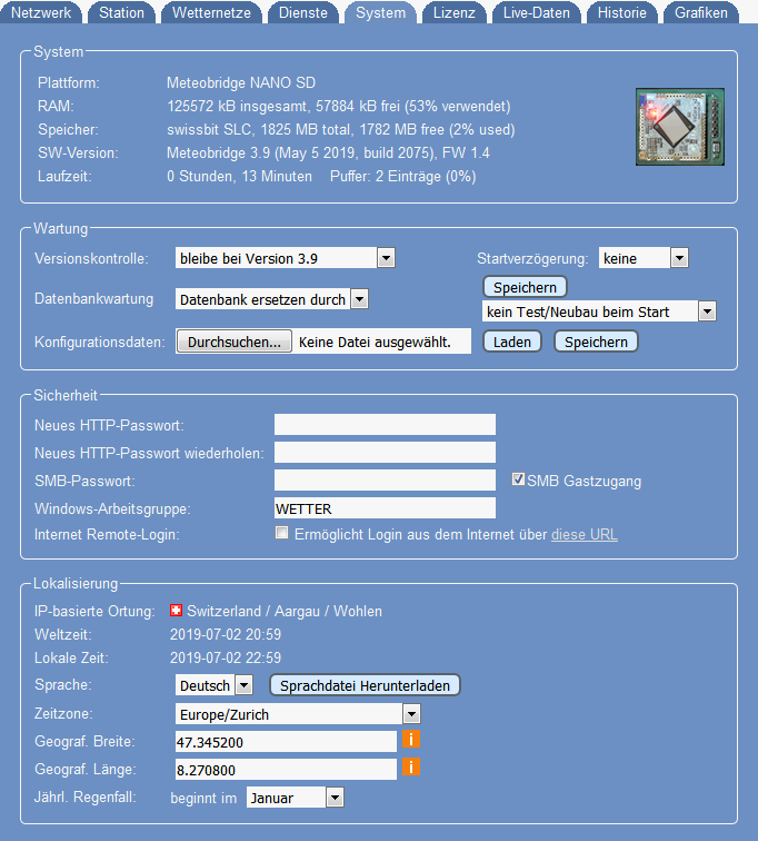

Sorry for the very late answers.
I have completely re-initialized the NANO SD several times (reset, 5x flashing), unfortunately without success.
I assign the IP addresses statically and have tried it with different free IP addresses. Again and again, the NANO SD is not available, the IP scanner used runs through again and again the whole possible IP range. The NANO SD is online, sometimes offline. All other devices and all other meteobridge are always online.
The web interface is compared to the other meteobridges very, very slowly loaded (sometimes factor 10x), again and again during the operation, the wireless connection is interrupted.
The NANO SD is not overloaded, only two services are running per minute.
After many Testst and since I have other meteobridges in use, I believe in a malfunction in the WLAN module.
- mb_pro_sd_system_.png (64.97 KiB) Viewed 6698 times

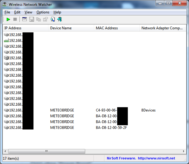

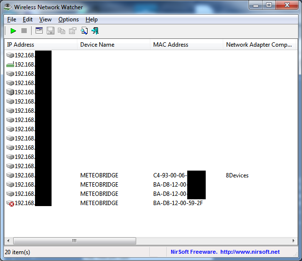

Re: Problems with the WLAN at Meteobridge NANO SD
Thanks for the two scenarios.
I have:
1x Meteobridge PRO
1x Meteobridge NANO (in a console)
1x Meteobridge NANO SD (in a console, black cable).
1x Meteobridge NANO SD (in a envoy, red cable, which causes problems).
All run smoothly with the same wireless settings, so I have in the latest NANO SD the same settings (auto, 2.4 GHz) without "Power Boost".
The NANO SD is sometimes recognized by the "Wireless Network Watcher" as online, sometimes offline. This is also true, when clicking on the NANO SD in any menu, the page is not found (offline).

- wnw_online_2019-07-05_ohne_ip.png (64.59 KiB) Viewed 6598 times
- wnw_offline_2019-07-05_ohne_ip.png (64.58 KiB) Viewed 6598 times
Try the power boost. your power supply seems fine to do so. If your WLAN issues are related to a weak WLAN connection this should help.
Please also try to operate the NANO in regular DHCP client mode and control fixed IP settings with your router based on the MAC of the NANO.
If that all does not help, I would propose a hardware change.
