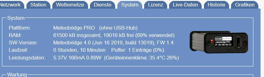

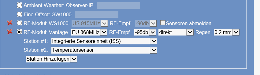

Posts: 1486
Re: meteobridge pro red no RF-Module
Do you have a Red or a Black? Your config shows a Black which does not have RF and connecting via a USB hub.
I am confused then why your system tab shows a picture of a Black?

Post by Großvater »
I am also confused, i rebooted then the red MB was a black MB

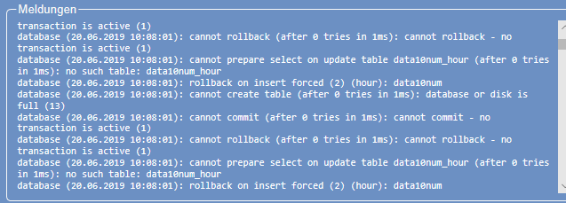

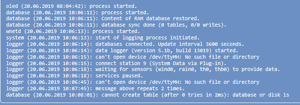

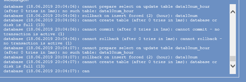

here the error logs
FORMAT FAILED!! on the Display of MB
This looks pretty sure like a defect of the USB hub chip in the MB PRO.
Please contact "info(at)meteobridge.com" to get this fixed. Sorry for the hassle.
