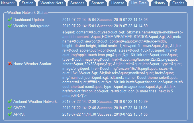

After enabling Weather Net Home Weather Station - Weather34 I am seeing an error in Live Data. Under Weather Nets I am seeing a green check using API URL http://172.22.40.75/PWS/index.php but under Live Data I'm seeing a Red X for HWS.
Do I need to have HWS-Weather34 configured under Weather Nets since I have the Local Dashboard working well for Local and Remote access?
What is the purpose of HWS - Weather34 under Weather Nets?
I originally enabled HWS before I discovered the Local Dashboard needed to be setup for the Local and Remote displays to function.

- Live Data Error.PNG (41.23 KiB) Viewed 1651 times

the home weather station in networks is to provide pre configured data around about 190 pre defined values to a website using the web version of the template.
https://github.com/lightmaster/Meteobri ... 4-Template
unless you have the template installed on a web server and set the path correctly ,hence why your seeing that red cross .better off disabling it if not using web version..

Thanks for the reply I disabled it for now.
