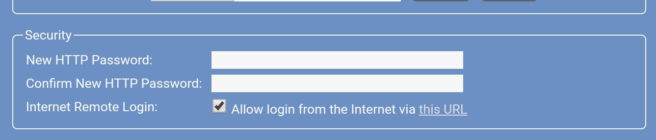

Seems to me like a networking issue then. Maybe you have an IP conflict, or bad Ethernet cable or bad Ethernet port.
For Meteobridge remote access you don't have to open any firewall ports. The process is very simple. Just turn on check box that says, "Allow login from the Internet" under System tab. Then you use the "this URL" link following that statement. All Boris needs is that link and your password. You should bookmark that URL so that you can remote in also, as it is quite handy.
Meteobridge RPI | GW1000

That is a nice and convenient way to handle things. Done and done.
