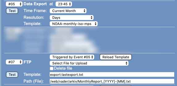

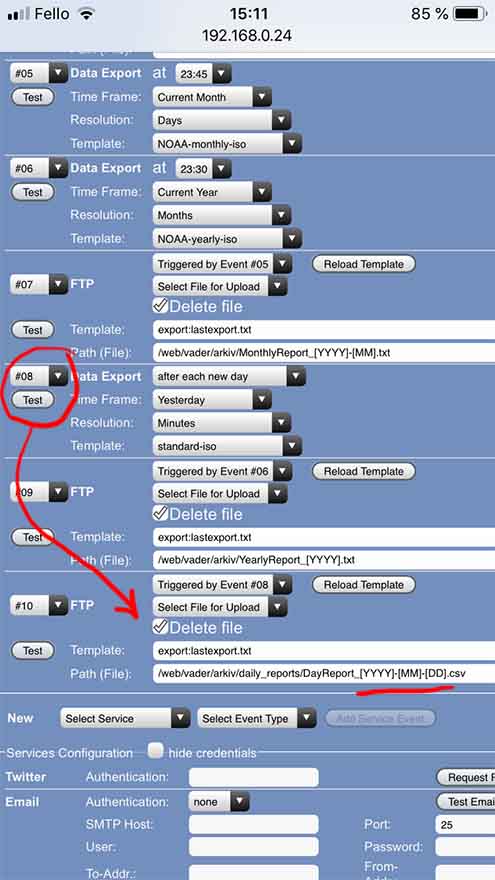

Apart from my monthly and daily reports that are generated every night. I save them to my server with a datecode such as:
Montlyreport_[YYYY]-[MM].txt <-- The monthly report, resolution per day
Dailyreport_[YYYY]-[MM]-[DD].csv <-- Daily report, resolution per minute
One entry on the system tab generates the export, and one that is triggered by that event uploads with ftp.

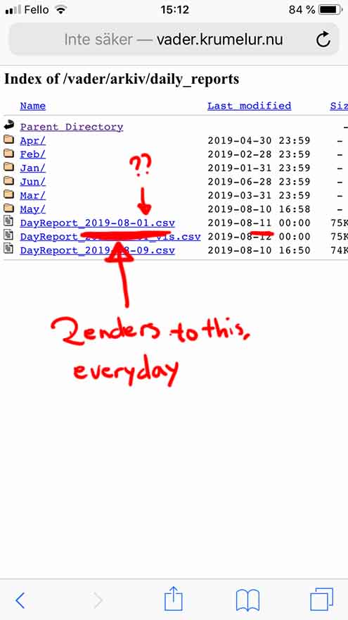

If I run this using the "test" button it works out fine. But when run triggered the last datecode - month for the monthlyreport and day for the dailyreport is set to 01, so I get no daily reports saved since it is overwriting itself. The montly overwrites january every night.

Attach screendump for the dailyreport settings and the outcome.
Any ideas what this might be?? :?:

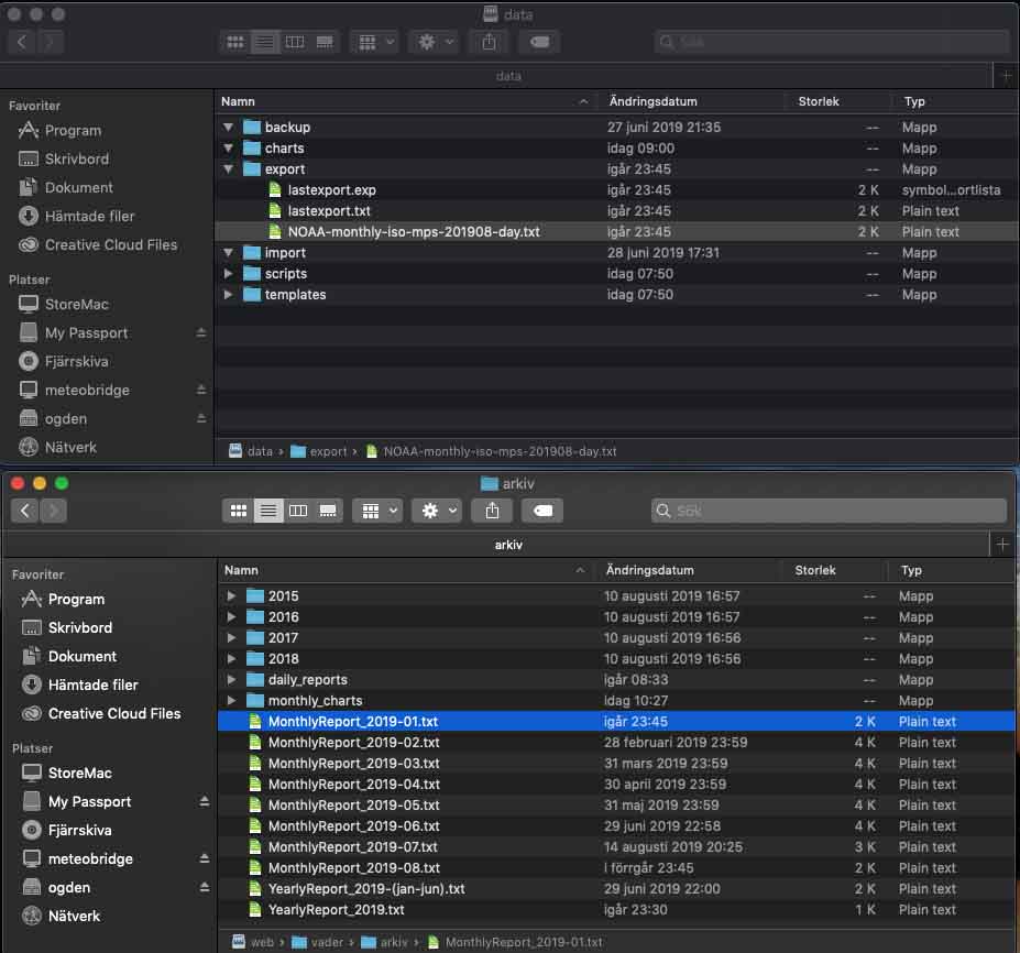

I tried to revert to a triggered event for ftp and unchecked the delete-box. The generated file in the export folder is ok with datecode 201908 (I have also tried different names on the template, but without any difference). But when it uploads it translates to 2019-01. I guess the screenshots tell it all.
If I use the strftime it works correctly, so that is a good workaround as long as I keep uploads on the same day as they are valid (i.e. right before midnight).
