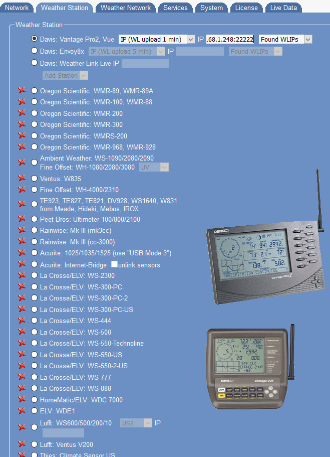

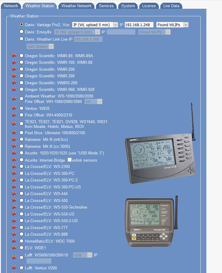

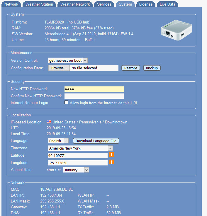

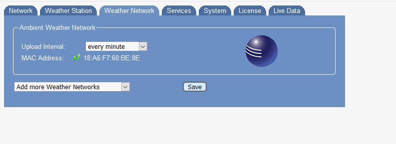

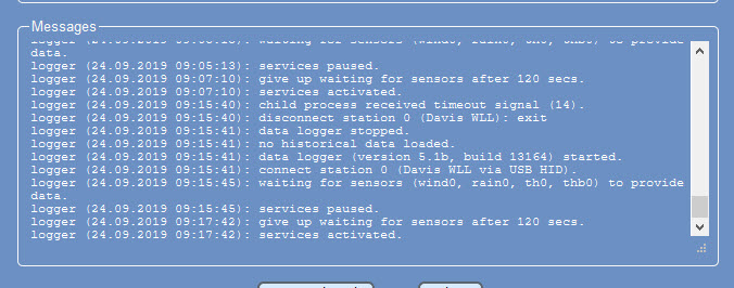

Hello all,
I purchased Weatherbridge from Ambient last week. I currently run a Davis Vantage Pro 2 with WeatherLinkIP 6555. I will share my connections and set up attached below. I have been struggling for the last 4 days with getting the Vantage Pro to communicate with Weatherbridge. I have no issues with connecting the Vantage Pro with the weatherlink.com live site...I have connected both the Vantage Pro and the Weatherbridge to the same router (FIOS). I was on another forum WxForum.net and one contributor there offered a lot of help and troubleshooting ideas. But we have been unable to get the communication established. He thought this may be a great site to tap into the knowledge set here to solve this issue.
Please see the attached screenshots and let me know what other information you need in addition to the below to assist me with this issue. Thanks so much in advance for any help and ideas.

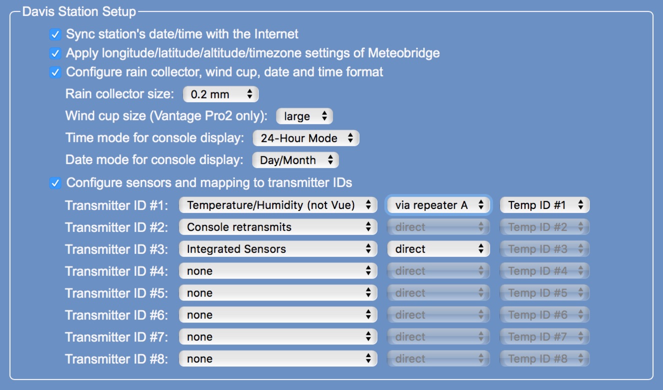

Re: Trouble with Weatherbridge set up with Davis IP Logger
Have you configured the Meteobridge Station Setup to have the Integrated Sensors as Direct ( Transmitter ID #1 ) in the Davis Station Setup Page which should have come up after you selected the Vantage ?
Hi Big,
My screen doesn't give me those options - see the below for the option if I choose weatherlink IP
- Davis setup.jpg (190.06 KiB) Viewed 6603 times
What version of firmware is installed ( found on the System Page Tab ) ?. If you don’t have the latest firmware ( currently Version 4.1 Sept 21,2019 ) please do a reboot from the System Page which will automatically install the latest firmware.
Hi Big
Did you mean add that port 22222 to the IP box? the box next to it does not allow entry it just finds the WL IP
I added the port to the IP address but still no luck
Any other thoughts??
Thanks!
Paul
Thanks!
Paul
- station setup2.jpg (197.73 KiB) Viewed 6574 times
Did you select the drop down menu for Found WLIPs after the IP address entry box and see if your WLIP is shown.
Is the address you’re entering as your WLIP the same address as your Meteobridge is using because they have different addresses ? . Try leaving the IP address of the vantage Vue IP address box blank and trying the drop down menu of the Found WLIP’s box to see what your Weathetbridge finds as your WLIP IP address. That will either automatically enter the correct address or then enter that IP address.
It should be the same IP address as the one that you’re successfully using to upload to Weatherlink.
If all else fails, reboot your Vantage2 Console by removing both the power supply and one of the batteries and then reinstalling both and waiting for it to fully boot up. Then try the Found WLIP’s box.
If none of these things work it suggests a hardware problem. Contact Ambient Weather Customer Service.
