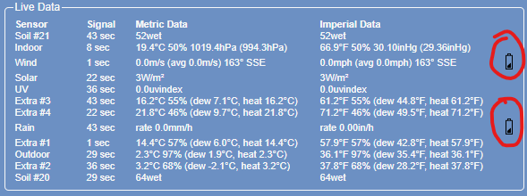

I am running a GW1000 station and am getting a low battery symbol for both the rain gauge and anemometer. They are both brand new with new batteries and the Ecowitt app does not show low batteries. Is the low battery feature in meteobridge supposed to work properly with Ecowitt hardware?
My sensors are:
WH32 - Outdoor Temperature and Humidity Sensor
WS68 - Anemometer with Light & UV Sensor
WH40 - Rain Gauge Sensor
(x4) WH31 - Add-on Temperature and Humidity Sensor
(x2) WH51 - Soil Moisture Sensor

I've noticed that those battery icons only show up when GW1000 is first powered on or when it reboots (after firmware update or if done manually). The icons then go away shortly afterwards. I think the icons are indicating signal strength not battery. When the GW1000 first starts up the signal strength in WS View app is zero bars and then it climbs up one bar at a time. As long as there is no lost RF packets the signal strength climbs. Then when the signal strength is full the battery icon in the Meteobridge goes away. Therefore it just seems like the Meteobridge has been mis-coded to show battery when it should be showing signal strength instead for this data that it is getting from the GW1000. I just ignore it. I suppose it could be fixed but I never bothered to mention it.

For mine they show all of the time on the rain and anemometer even with good signal.
