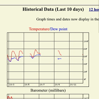

Breno
Posts: 22
Joined: Sat Nov 12, 2016 8:05 am
Re: tplink 3020
Post by Breno »
Holes in data
