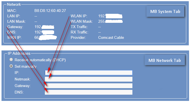

The MAC address on my MB NANO SD system tab is B8:D8:12:60:40:27, however it shows up as BA:D8:12:00:40:27 on my router and on an IP scanner.
  • Why is that?
  • Which one should I use when setting up a static IP?
  • Should I set up the static IP within MB first and my router second or the reverse?
  • When setting up a static IP, please see the screenshot and advise if it looks OK or advise what I should correct.
Meteobridge Network Settings.png (64.85 KiB) Viewed 2026 times
Re: MAC Address and Static IP
ad 1) The Vocore2 module of the NANO has lots of MACs (LAN, WLAN) and Meteobridge SW selects one of those to work with.
ad 2) When you want to tell your router to keep giving the NANO a fixed IP, use the one that lists up in your router logs.
ad 3) You should have your NANO keep working on DHCP and give the task to assign a fixed IP to your router.
ad 4) You have tons of chances to make the static IP settings wrong (Gateway, DNS, mask). When you are not 100% up to networking details (and your questions do point me in that direction) just stay with DHCP and use option 3)
