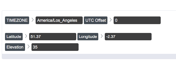

don't need to edit system or change anything system tab use the setup menu in dashboard itself example below
Screenshot at Nov 24 23-51-33.png (19.74 KiB) Viewed 2452 times

I did use the system tab and selected America/Los_Angeles as in your screenshot. It didn't fix the problem, so I selected America/Tijuana because that location is still in my timezone, and this selection does not include an '_' . This worked for me. I believe I read a post where someone else had this problem but they did some editing to fix it. Sorry I don't know where that post is now.
