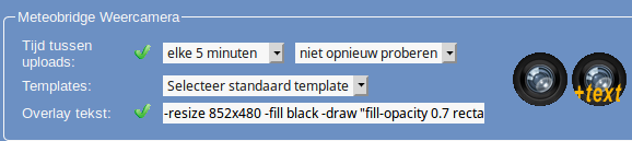

Hey,
i've a question,
I have foscam FI9803p ip-webcam with meteobridge
I would like to upload an image with temperature wind etc. to my website. i can fill in meteobridge:
IMP. EN (Cam 1.1)
IMP. EN (Cam 1.2/3x)
ISO EN (Cam 1.1)
ISO EN (Cam 1.2/3x)
ISO DE (Cam 1.1)
ISO DE (Cam 1.2/3x)
the chosen value will not remember in meteobridge.
What for value i choose meteobridge always return to " standard " value.
What must i do to desolve this???
Greetings
Engelbert

Re: webcam upload via meteobridge
Tab Weather Nets => Meteobridge Weather Camera:
That uploads and process a camera image to https://admin.meteobridge.com/cam/. . . . .
Selecting the different possibilities in NL = "Selecteer standaard template" EN = "Select Standard Template"
copies the values once to the entry box below the selector.
Or you can use an example stream as discussed on other forums and paste them in the entry box without using the selector-dropdown.
You can copy / adapt those settings but you always have to save them , using the "Save" button at the bottom of the page.
Your selection/changes are kept that way until you make another selection in the dropdown selector AND press save again.
The correct link to the image without the extra values and with the extra values can be found by clicking on the two lenses at the right.
You can use these links on your website directly.
Tab Services => FTP Cam:
That upload is used when you want the "unaltered" camera image uploaded to your site.
Succes, Wim
