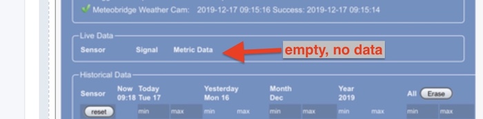

Please see attached screen shot.
I have rebooted the device without success.
Live data shows normal.

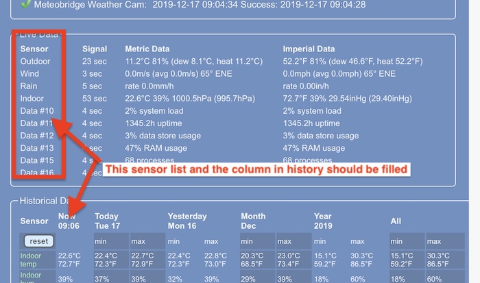

There is NO live data visible.
So the contact with the weather-station is lost.
The data in the lower block is history, the block in the middle should show latest measurements = live data.
