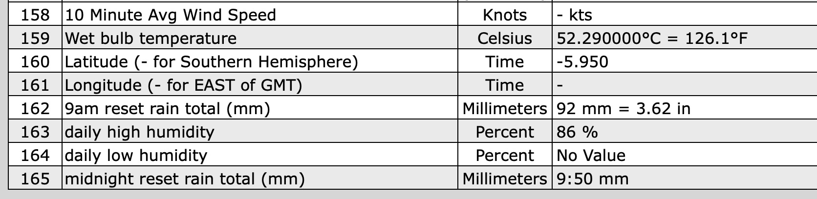

I discovered an error in the Clientraw file. It started after upgrading to the december '19 version (4.2?) Reverting to 4.1 did not help.
I checked my Clientraw.txt file at https://saratoga-weather.org/wdparser/index.php and in line 158, wich should be wet bulb temp the lat.(52.2900000) is shown, wich should be in line 159. The longitude is shown in line 160 instead of 161
The attached screenshot shows the error.
Schermafbeelding 2019-12-26 om 23.22.24.jpg (153.29 KiB) Viewed 1921 times
It looks like something not too complex to fix. But then again, i could be wrong :D
Thanks, Gerhard

Now normal again. Saw this behaviour a couple of times before. Don't know what caused it, and don't know what solved it!

I guess some parameter is missing sometimes and that makes the whole list being misaligned after that. If you could find the exact position where it does go south (sometimes), that would help me to spot the bug.
Did I already mention that the clientraw format is THE example of asking for errors per design ;-)
