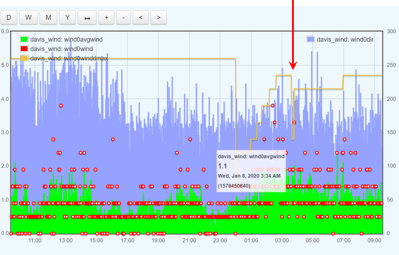

I didn't have to wait long for it to happen again. The sending to WU stopped at 3:33 am on January 8th, 2020. Before and after this time, the meteorite successfully sends emails. The mail at 3:33 am probably triggered the error?
Here I show the state that shows up at 9:20 the next morning.

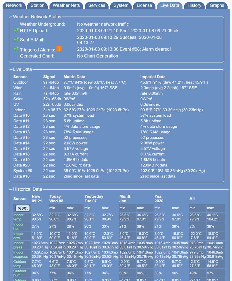

Here you can see the stopping of all data:
Here you can see "Live Data" at 9:21 am, so data continues to come from the station even after the error.

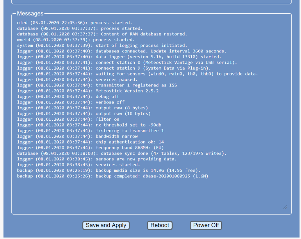

Here you can see the messages. At 3:37 there are entries, shortly after stopping what is happening in the system.

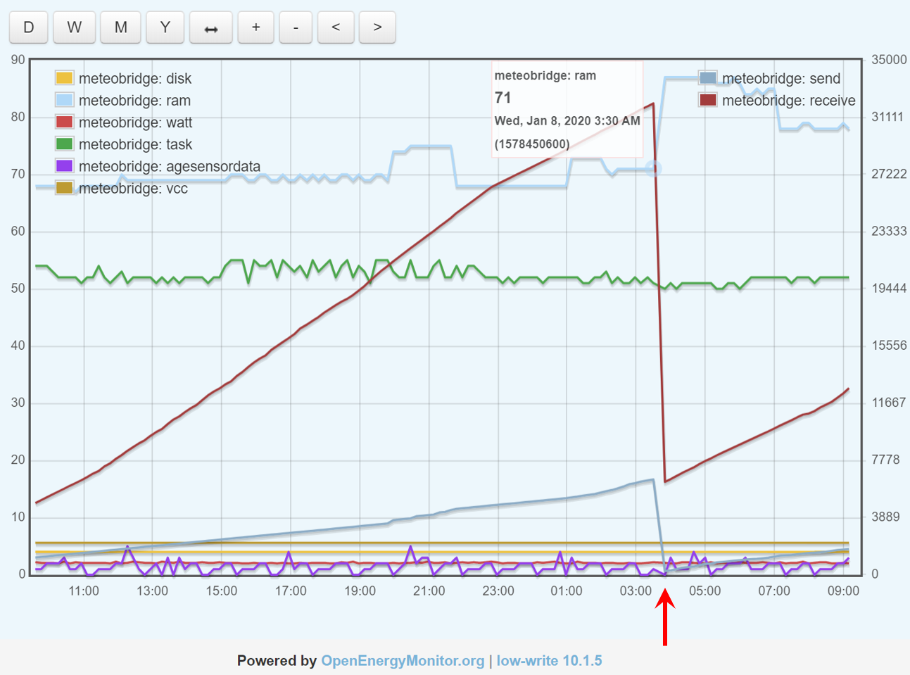

With an HTTP request I send a few system variables to a monitoring system every 5 minutes. There you can see that at the time when the RAM value rises sharply. I think that's why the system data for sending and receiving was reset.
Here you can see that the processing of data and the sending of the HTTP request continues and data also comes from the weather station (here data shown by the wind).
One fact is special: the maximum value for the wind per day is rest on 0:00. At the time of the error, it is also reset. The max value can only go up or stay the same over the course of the day, but never get lower!
Finally, the status of Wether Nets. There are only green checks.
