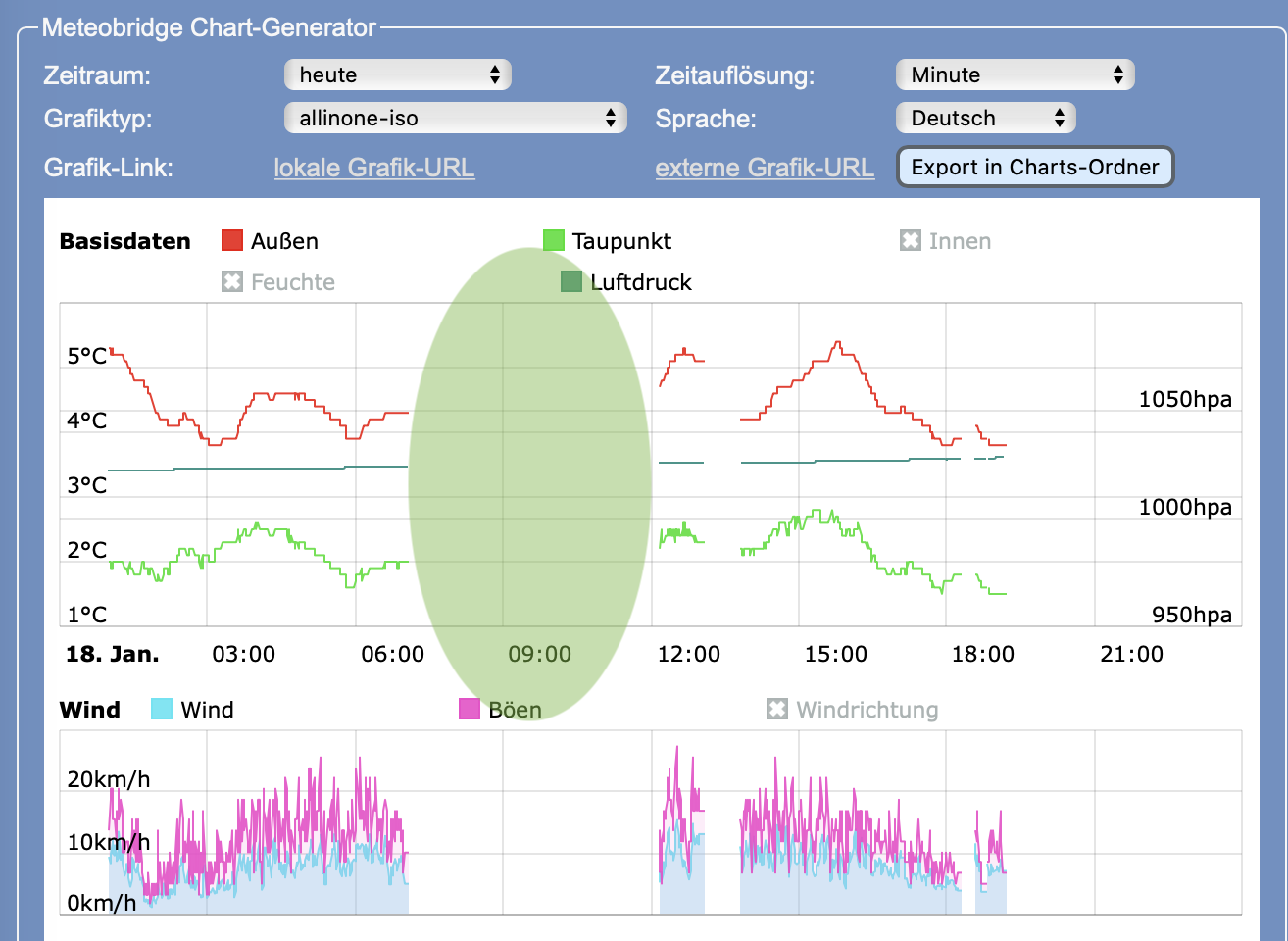

I had to disconnect the Meteobridge PRO from power, and after powering it on again I noticed that data of 5 hours are lost. See attached screenshot:
Disconnecting from power happened at 12:07pm, but data between 7:07 am and 12:07 pm was lost, although in station settings, the time interval to save historical data is set to 30 minutes.
This happens whenever power is lost. Can somebody explain this and offer a solution? Many thanks in advance!

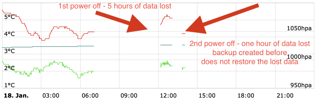

I tested this and removed power from my MB Pro, and this time data of about one hour got lost. Before I removed power, I created a backup of the database, but restoring the database actually did not restore the data that got lost. That means to me that the data that was lost actually never existed in the database, or it did not exist in a proper format, or whatever. I have no clue.
So, whenever the MB looses power, more or less data is lost. This totally unacceptable and I would like to know what I can do to fix that (if there is anything I can do). Maybe this is even a bug within the system. In any case, I can reproduce this problem in a targeted manner: with every power cut, the MB loses data, either for several hours or for a shorter period of time.

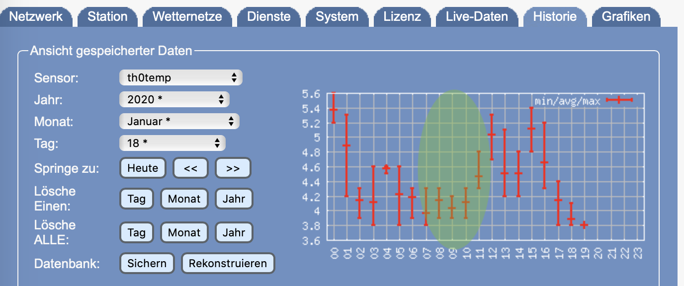

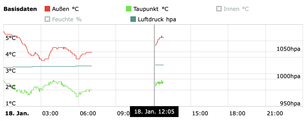

I did some more research and have now found out that on the 'Historical data' tab, data from the missing time span seems to be there:
But when I create a chart for the same day, data is not there. There's something fundamentally wrong here, either with the database, or with the chart generator.

Per minute data is only kept in a RAM database. When a proper shutdown happens RAM database is stored permanently and restored from that on reboot. But if you have a hard shutdown (like power fail) this gap will appear.
So no bug, but to be expected behavior.
