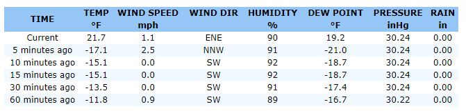

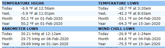

I updated my MB on Feb 9 when the new 4.3 update was released. After that, it has been sending erroneous temp data to my weather website (saratoga USA base template) as well as my hourly conditions tweets. All data prior to that update was fine. I've tried restarting the MB and it still reports incorrectly. I made no changes to any of the tweet string, services or MB tag data before or after the update. As I said, everything was fine prior to the update. Some screen images are attached so you can see where the temps are way out there.

It's also not sending the tweet after every full hour (setting). The last one was nearly 8 hours ago as of this post and it just "stopped" yet. Here's the last one it sent showing the incorrect temperature and of course wind chill (-14.8F):
Conditions at 08:00PM - Temp -14.8°F Wind Chill -14.8°F Hum 74﹪ Winds WSW 1.1 to 1.1mph Rain 0.00in Baro 30.18inHg UV Index 0.0

should be fixed wih latest update.

So far, so good! Thanks!
