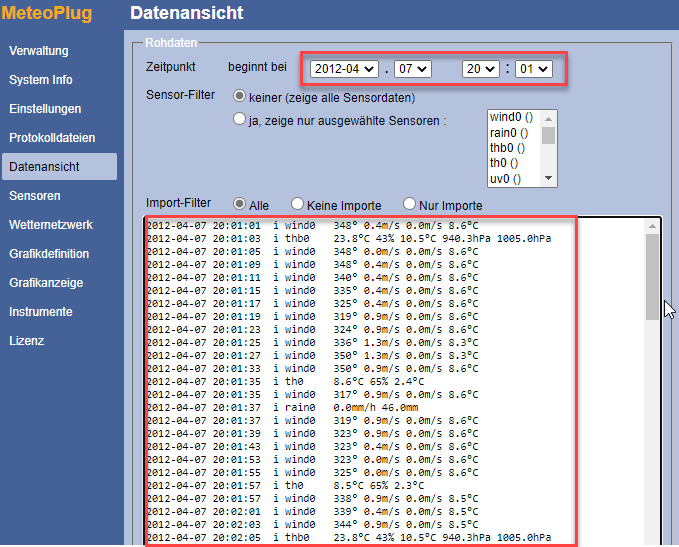

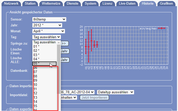

I try to import older data from meteoplug into meteobridge Nano SD. It seems that everything starts well but suddenly, the MB does a restart after about 5 -7 min. I can't say if the import process hast finished or not. But when I check the History Tab, for that specific month (April 2012 in my case) I can see that there are just a few days imported, instead of the whole month. And yes i tried this with other months but allways the same result, just a few days imported. Any ideas? Did I miss something?
Many Thanks in advance. marco
Here is what I can see in Meteoplug (April 2012)
meteobridge

and this after the import in meteobridge:
meteoplug
meteoplug

My Post above was only about importing Meteoplug files into meteobridge. But I had similar problems with all my "raw" files from meteohub:
Meteoplug import:
after a few times of trying suddenly the meteoplug-export files where imported correct. (no idea why, I'll try to figure out)
Meteohub import:
I found out, that almost all my "raw" files from meteohub had at least one line that where not in the correct order. So I sorted every single "raw" file, before I did the import. I'm not finished with whole import task but until now it looks good.
