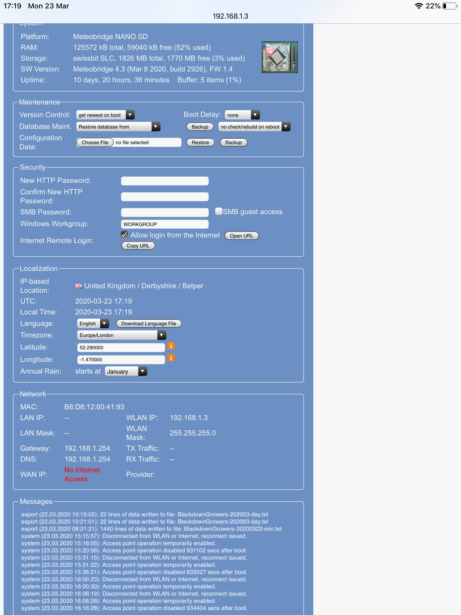

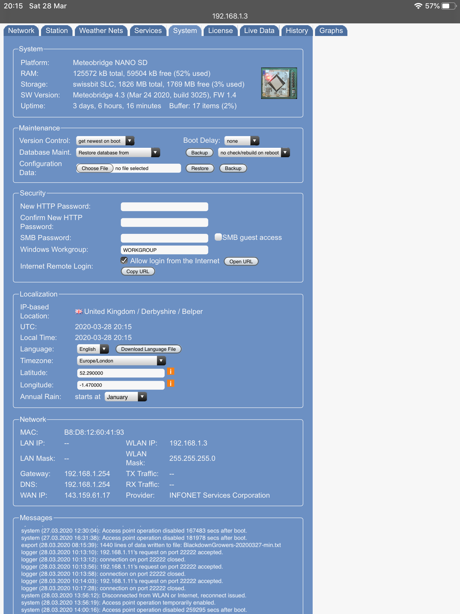

Following a reply to an apparently similar problem in the Meteobridge discussion I swapped the Davis 1 amp supply for an uprated 2 amp supply. Unfortunately the problem reoccurred within 2 days with both the Local Dashboard and Weather Underground enabled. Rebooting cleared the problem. Note that the internet was running despite the WLAN IP indicating there was ‘no internet’. I suggest that this might be a clue to the update problem possibly the Nano SD is losing the internet connection for some reason.
System page at failure.

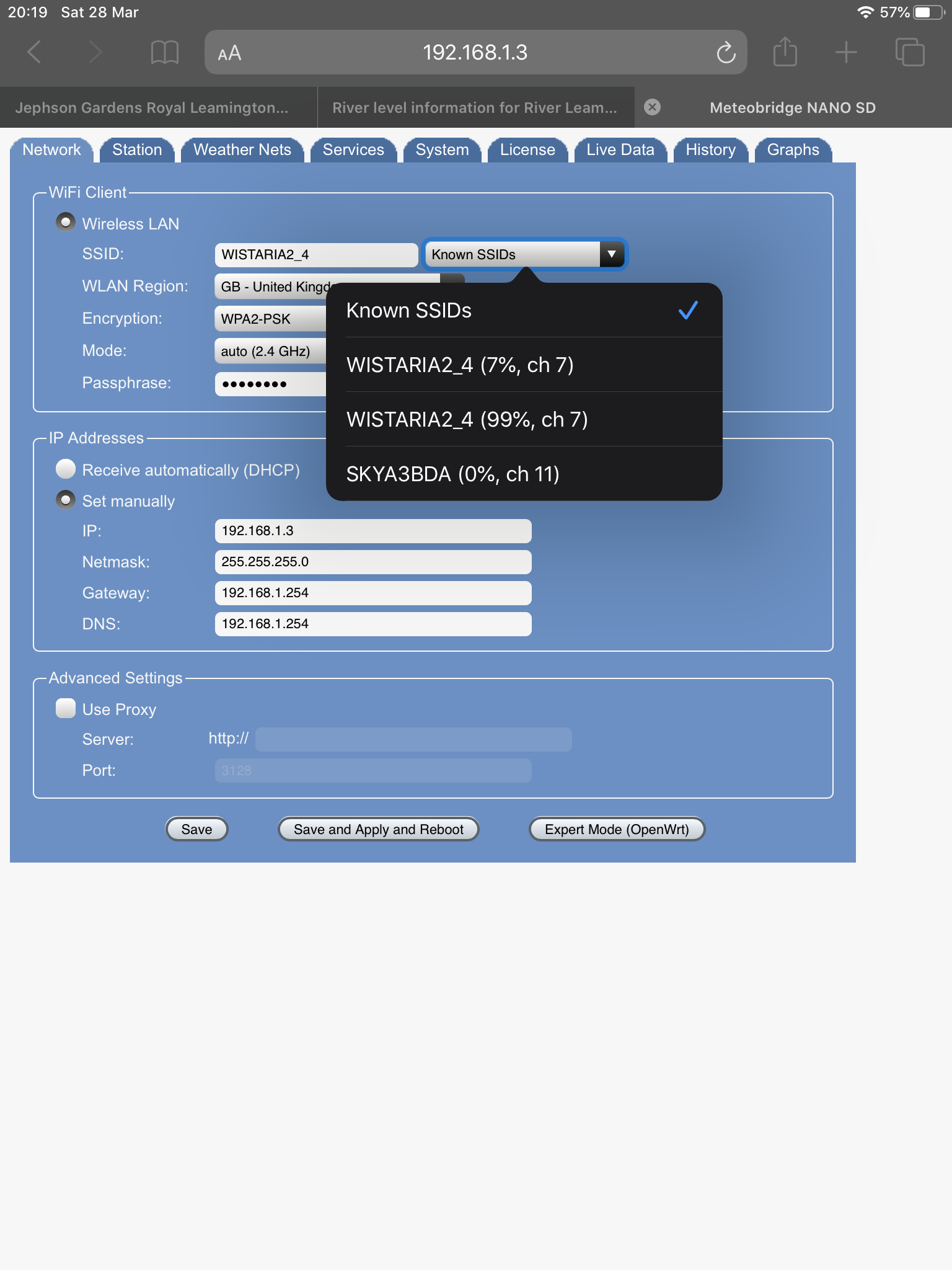

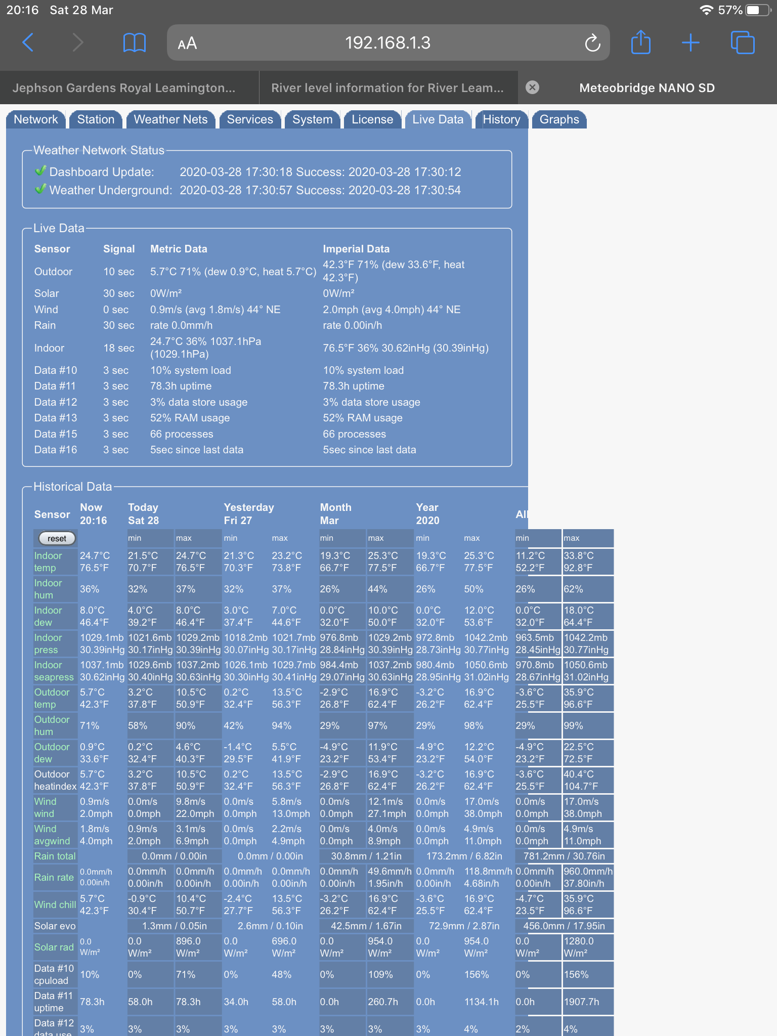

I have applied manual ip addresses, fixed channel 7 on the router as suggested by members and still the updates stopped, as can be seen from the attachments. The wifi signal is good and the WLAN is working. This had not used to happen when I first used Nano SD in May 2019. It is not possible to support Weather Underground or even local dashboard as it stands. Could the problem be the use of a wifi repeater, hence the two wistaria_2.4 signals?
Good signal and manual ip
No updates 3 hours, why has it stopped?
Buffer filling. WLAN connected

Agreed ToTo, but as I show in the network screen shot the Nano card ‘sees’ two router signals, one from the router directly (7%) and one from the repeater (99%). I assume the best signal is used but maybe it connects to the weaker signal on occasions causing problems. I’ve set to the router to avoid channel hopping at channel 7 as suggested elsewhere. My only other thought is to turn the repeater off and move the Davis Pro2 to a location with a better direct signal from the router and see if that cures the problem in the short term. However, the location would be unsatisfactory long term. Moving the router is not an option, after all that’s why we have repeaters.

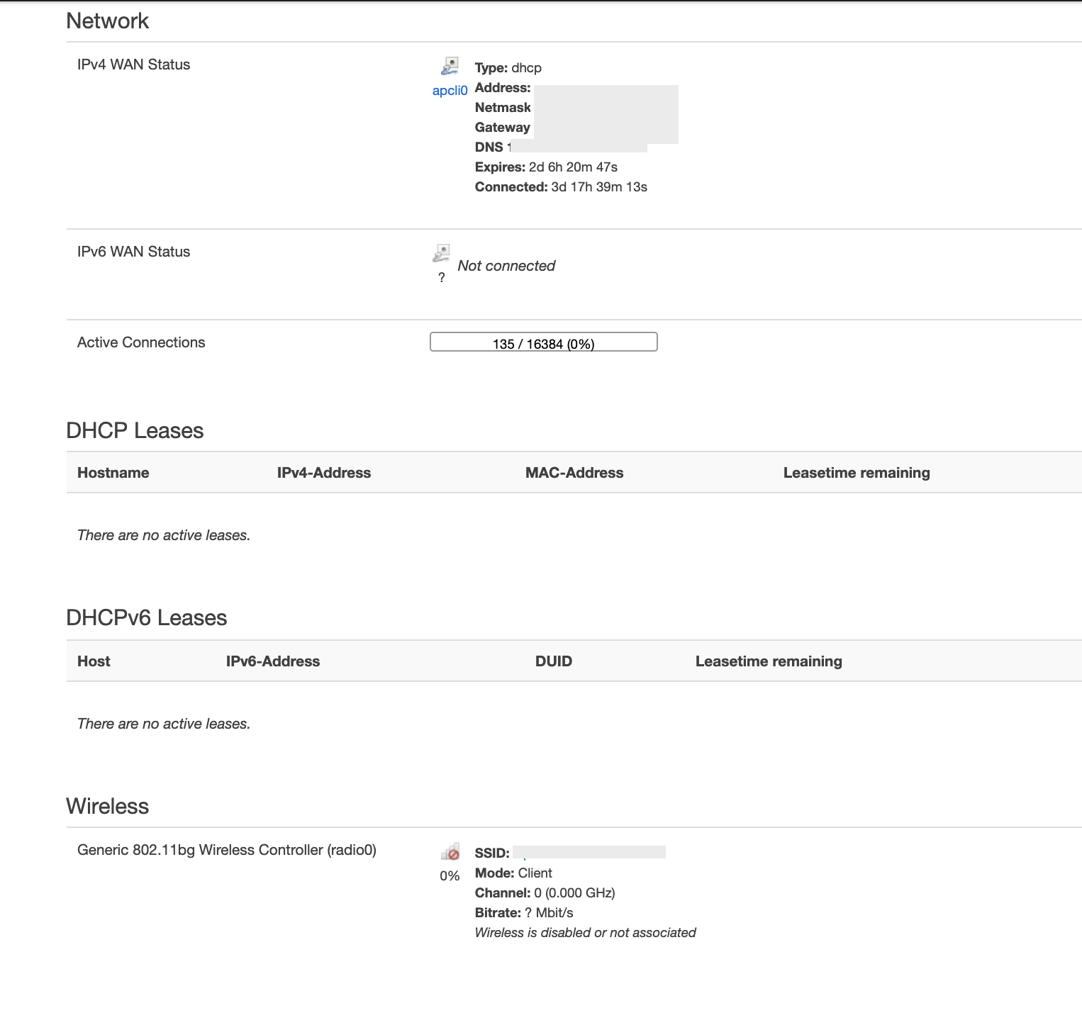

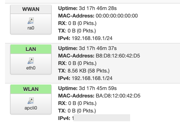

Over the last 2 days it happened two times to me. Looks like most/all of the weatherdata related functionally stops working (export, writing to the DB), but the webui is still reachable with an acceptable latency & speed.
I can help myself with rebooting my repeater and then everything works fine again (and I don't loose any data).
That indicates to me that some processes are waiting for some signal or is some kind of blocked.
Is there a way to restart the WiFi interface on the nano ? From the openwrt interface it's not clear which one I should take - one has the IP but the other is showing the traffic
