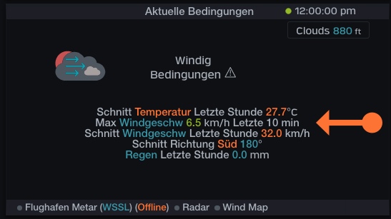

The display of the Weather34-Home-Weatherstation-Console, here there seem to be conflicts with the codepage: Special characters are displayed incorrectly in the German translation, as an example:
"Average temperature last hour 8.9°C"
or
"Cut direction Süd 185°"
Is it possible to correct this?

I can't help with the internal stuff of NANOSD but if you mean the recent console version for website here is what Im seeing in the console version .xray77 wrote: Sun Mar 15, 2020 1:23 pm Hello,
or

console version screenshot in German
or do you mean main template also shown in German because the average temperature last hour only appears as below
only thing I can think of at present is PHP mbstring extension is not enabled or installed but that is something you would have to look for . if you have a php info file called phpinfo.php with this <?php phpinfo(); ?> in it you can run it and it will list what extensions are installed and enabled. Brian

I have now checked the codepage settings of my webhoster, changed the setting to codepage utf-8 and it works since then! So it was probably because of that.

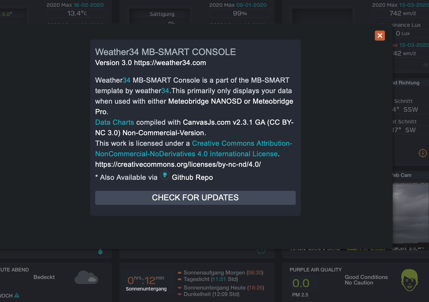

Another little issue: When I click on the Version Info button at the bottom right of the console, the version information is version 3.0 although I had downloaded and installed version 4.0.
Weather34 MB-SMART CONSOLE
Version 3.0 https://weather34.com

ok thats good you found a solution , has for ver number ill update it near or far distant future but thank you for raising ,highlighting it..xray77 wrote: Sun Mar 15, 2020 7:06 pm Hello weatherist34,

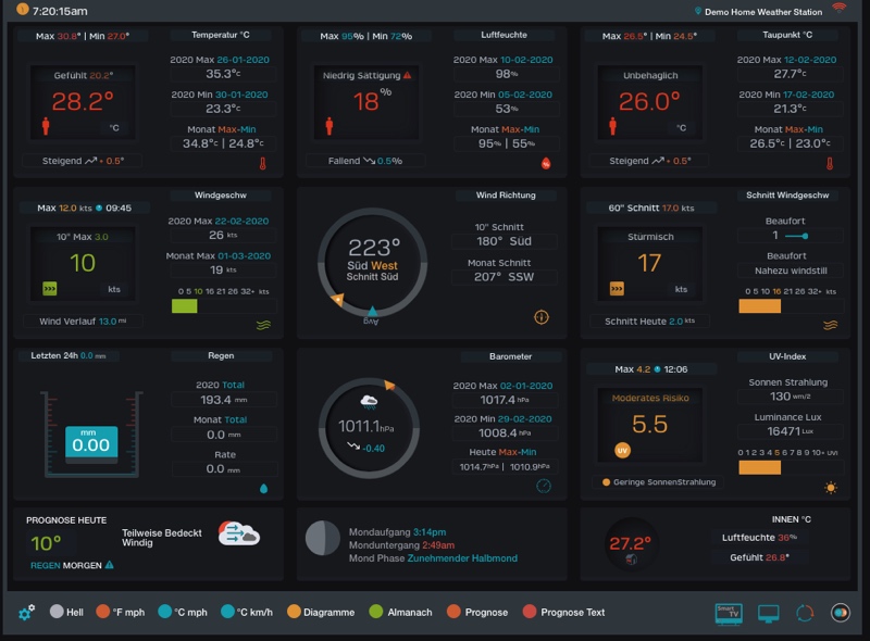

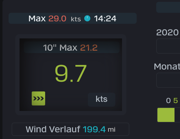

I still have a question about the display of the wind speed on the display. Is it possible to display it without decimals? I prefer the wind-display in the unit knots, here a resolution without decimals is standard.
e.g. 9,7 kts displayed as 10 kts..?

Knots was on the list todo just needed to focus on the color sequences but this is where it is at live example http://www.bobhewitt.co.uk/MBSMART/cons ... edavis.php
or screenshot using knots the last part needed was to convert the forecast wind readings . it is based on default units for forecast using mph(uk) or universal km/h there is no conversion yet added for non metric or m/s to knots that will have to come at a later date.

screenshot using single digit KNOTS *note it now has the option to use/switch to KNOTS from bottom bar.
