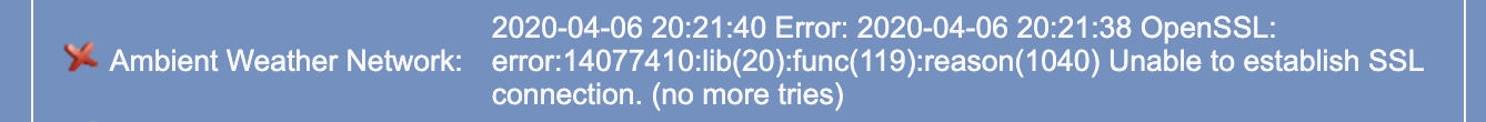

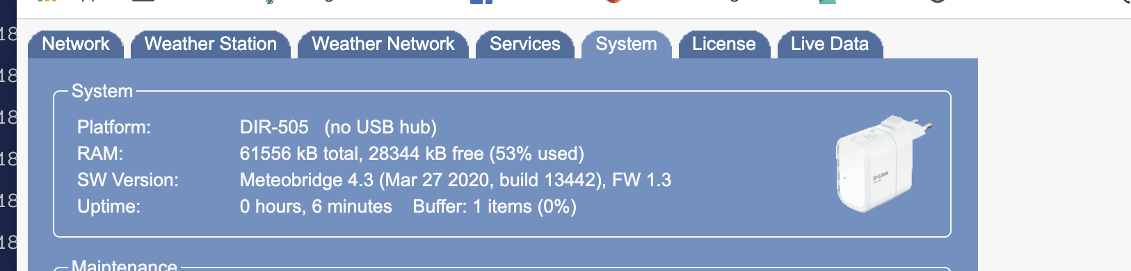

I'm on 4.3 (Meteobridge 4.3 (Mar 27 2020, build 13442), FW 1.3) and still getting:
Ambient Weather Network: 2020-04-06 20:20:28 Error: 2020-04-06 20:20:26 OpenSSL: error:14077410:lib(20):func(119):reason(1040) Unable to establish SSL connection. (no more tries)

That is because you are on the DIR-505 platform, which is very rare (and not sold by Ambientweather) and might have been overlooked when doing the TLS wget update with version 4.1. I will put it on my todo list.
Re: Ambientweather network drops support for HTTPS SSL uploads and now enforces TLS -> needs Meteobridge 4.1 or newer
Just released Meteobridge version does fix this for DIR-505 platform as well.
