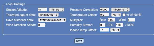

use the offset option under station tab .. -7 gets me close indoor thermometer from AC/Heater control
Screenshot at Apr 15 14-06-30.png (40.77 KiB) Viewed 1477 times

You can also adjust in the console itself to have display data on the console also corrected.
You do that on "station page". It is part of the third item in "Davis station Setup" section.
