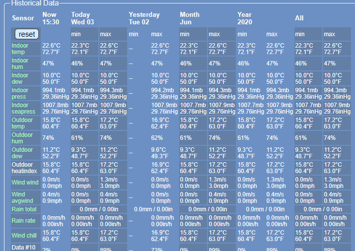

However, all the live data year and month historical statistics are now zero (as in annual rainfall) or only show todays max/min.

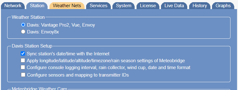

In the Nano SD Station tab there is no way to copy the historical max/min from the console.

It is the rain total at the end of every month updated. However the DB, after the import, shows 0.0mm not the values above.
