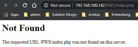

I'm having a little bit of trouble setting up my Local Dashboard. I have activated in in the Interface and restarted the Nano SD and also the base station many times. But the Dashboard does not show up at any time. I try to connect with the URL http://192.168.100.142/PWS/index.php (which is the correct IP of the Nano SD) and get the error "The requested URL /PWS/index.php was not found on this server.".

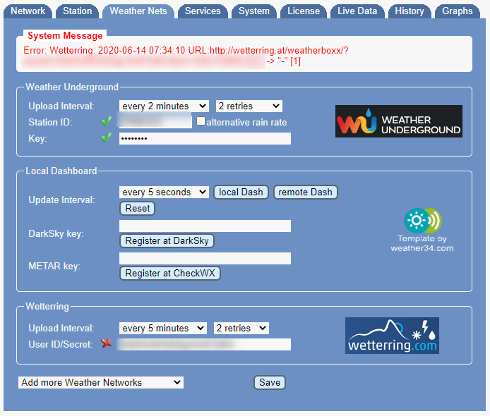

I would appreciate some help to setting up the local dashboard. Here is a screenshot of the current settings:

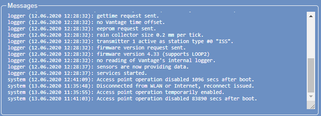

Here is a screenshot of the LOG Messages:
database (12.06.2020 12:28:12): process started.
database (12.06.2020 12:28:12): Content of RAM database restored.
wnetd  (12.06.2020 12:28:15): process started.
system (12.06.2020 12:28:15): start of logging process initiated.
wnetd  (12.06.2020 12:28:15): send data thread started (pid:2056 tid:2057)
logger (12.06.2020 12:28:16): databases connected. Update interval 3600 seconds.
logger (12.06.2020 12:28:16): data logger (version 5.1d, build 3113) started.
logger (12.06.2020 12:28:18): connect station 0 (Vantage via USB serial).
logger (12.06.2020 12:28:18): connect station 9 (System Data via Plug-in).
logger (12.06.2020 12:28:18): wakeup sent.
logger (12.06.2020 12:28:21): waiting for sensors (wind0, rain0, th0, thb0) to provide data.
logger (12.06.2020 12:28:21): services paused.
logger (12.06.2020 12:28:21): no need to update console date/time.
logger (12.06.2020 12:28:22): setup script executed.
logger (12.06.2020 12:28:22): internal logger activated.
logger (12.06.2020 12:28:22): syncing.
database (12.06.2020 12:28:24): database sync done (26 tables, 5/2055 writes).
logger (12.06.2020 12:28:32): gettime request sent.
logger (12.06.2020 12:28:32): no Vantage time offset.
logger (12.06.2020 12:28:32): eeprom request sent.
logger (12.06.2020 12:28:32): rain collector size 0.2 mm per tick.
logger (12.06.2020 12:28:32): transmitter 1 active as station type #0 "ISS".
logger (12.06.2020 12:28:32): firmware version request sent.
logger (12.06.2020 12:28:32): firmware version 4.33 (supports LOOP2)
logger (12.06.2020 12:28:32): no reading of Vantage's internal logger.
logger (12.06.2020 12:28:37): sensors are now providing data.
logger (12.06.2020 12:28:37): services started.
system (12.06.2020 12:41:09): Access point operation disabled 1096 secs after boot.
system (13.06.2020 11:35:48): Disconnected from WLAN or Internet, reconnect issued.
system (13.06.2020 11:35:55): Access point operation temporarily enabled.
system (13.06.2020 11:41:03): Access point operation disabled 83890 secs after boot.
The only thing that's really showing up is in the live data that there is a synchronization problem.

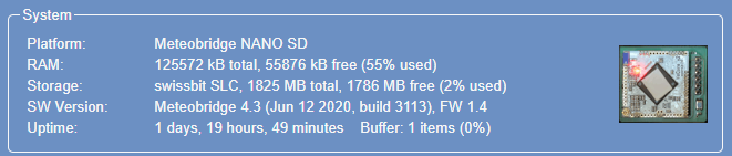

Here are also my system specs:

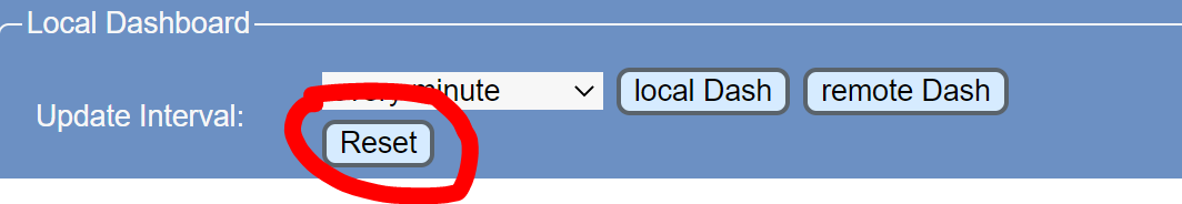

Have you tried using the reset button?
This reinstalls the software for you as stated by Boris: viewtopic.php?p=29958#p29958

/tmp/mnt/PWS/version needs to be deleted to have the NANO reloading the PWS stuff during reboot.

ConligWX wrote: Sun Jun 14, 2020 8:17 am Have you tried using the reset button?
Yes I have tried. It did not work.
Mattk wrote: Sun Jun 14, 2020 9:15 am /tmp/mnt/PWS/version needs to be deleted to have the NANO reloading the PWS stuff during reboot.
I did not try this. I have deleted the file and post after meteobridge has rebooted if it works or not.
Yes, this did the trick. Thank you alot.
I suggest you contact Boris then and report the reset feature is not working as intended
Re: Metebridge Nano SD - Local Dashboard **SOLVED**
"reset" should work on most recent versions. You have to do a manual reboot after that.
