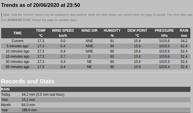

If you look at the attached screenshot under 'Records and Stats' it says: Today 34.2 mm (0.0 mm last hour)
It hasn't rained the last hour but as you can see under 'Trends' it says: Current 34.2mm, and 5, 10, 15, 30, 60 minutes ago 52.4mm
Meteobridge should have reset those values to '0' (rain0total-val 5, 10, 15, 30, 60)
Next time it rains, Meteobridge adds the new rain mm to the old values (52.4 mm)

Re: Wrong rain0total
There is some misunderstanding what the selectors do. When you read templates page of www.meteobridge.com you will see that "valxx" or "act" is not defined as a valid selector for a cumulative sensor like "rain0total". Just out of curiosity, what should "rain0total-act" give you? Current bucket tip counter? Sum of rain since yesterday, beginning of month, last summer?
Sensors that deliver cumulated data like "rain0total", "sol0evo" and "sun0total" should be used with the following selectors only:
hoursum, daysum or sumday, monthsum, yearsum, allsum, ydaysum: selects summarized delta values from today, this month, this year, all time or yesterday. Example: "rain0total-sumday" is todays rain fall.
For sensors delivering cumulated values like "rain0total" and "sol0evo" the following selectors are defined:
sum1, sum2, sum3, ..., sum60, sum1h, sum2h, sum3h, ..., sum24h: selects summarized delta values from the last one to 60 minutes or one to 24 hours. This is useful to get amount of total rain in a certain time frame: "rain0total-sum60" is rainfall in mm of last 60 minutes.
"rain0total-daysum" or "rain0total-sum15" is making sense. Please go with these and I would like to recommend to check the wiki next time you are stuck. 99% of the time you have it wrong instead of the SW. I am happy to take care of the 1% ;-)
A typical source of variance between what the console tells and what meteobridge reports is wrong time settings. When clock of the console is out of sync daily values will differ because of varying time frames of observation.
