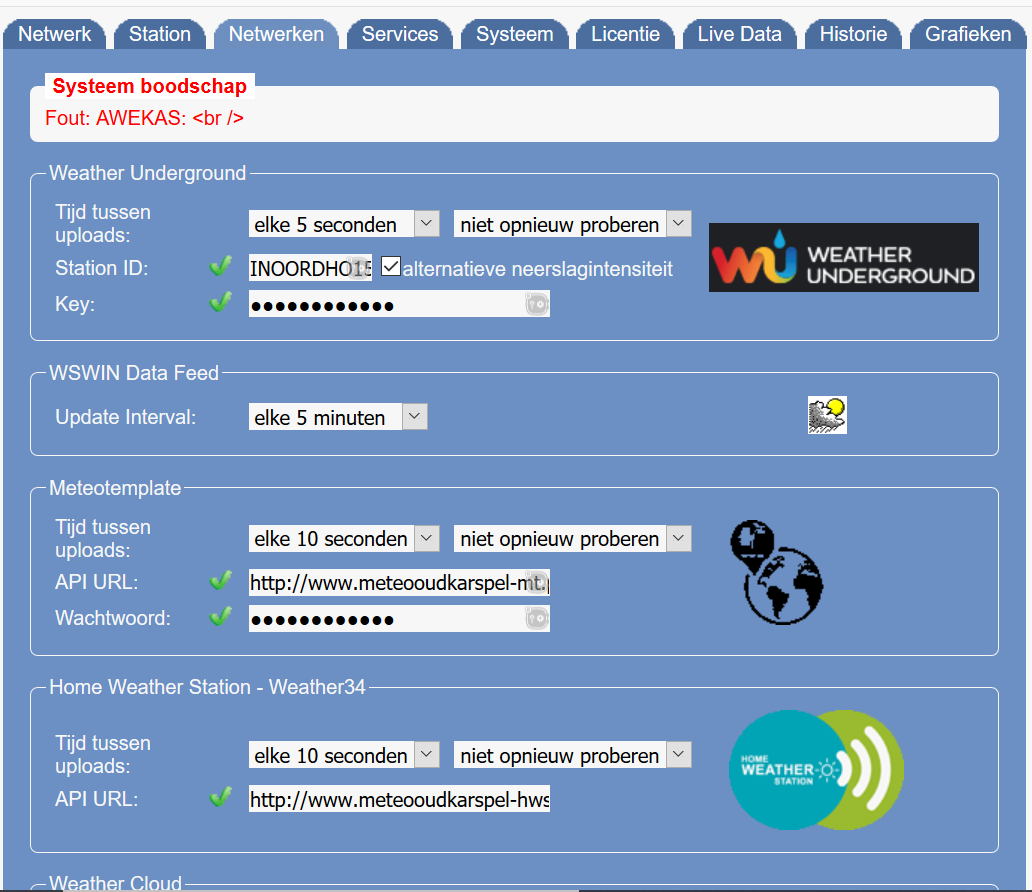

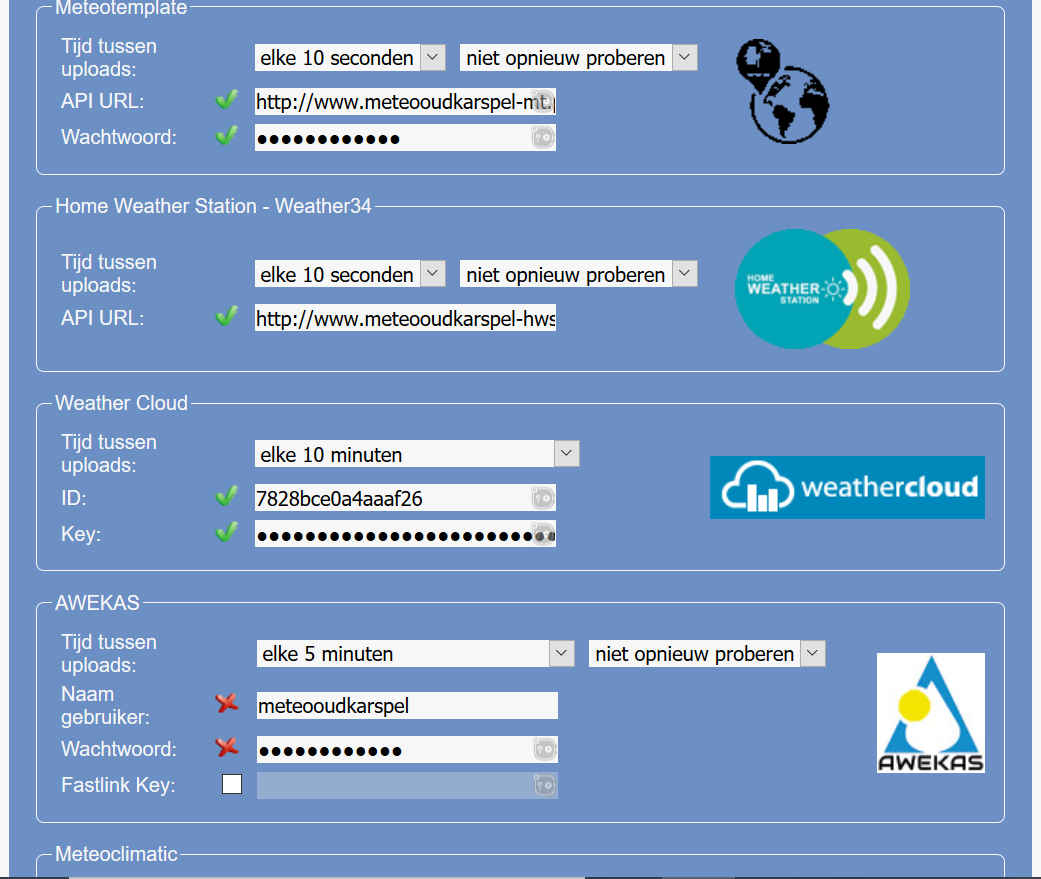

However, the meteobridge does send data to awekas again, but if you see 1 of the photos there are 2 red dots and on the photo you see that there is a system message Error: AWEKAS: <br />
is mentioned.
Can this be solved? Thank you very much.

That is strange. Could you provide remote login credentials to "info(at)meteobridge.com". That way I can have a look at what is causing this.

Boris the mail with my details have been sent to you.

Should be solved with latest update.
