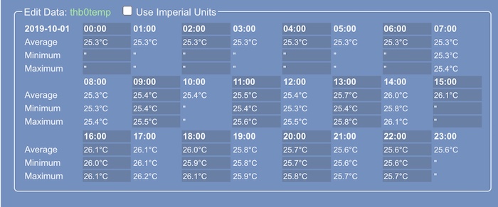

OK But when I check the NaNo database (AFAIK similar to the Pro database) the values have a resolution of 1 hour and contain average/max/min values. So if you want to compare "current" values it should comparing the average value of the current hour
https://www.meteobridge.com/wiki/index.php/Templates => Meteobridge PRO Additions
Using "[uv0index-avg@2015110316]" in a template will report average UV index on November 3, 2015 between 16:00 and 16:59.
If you want to compare current ( it is now 202006271730 ) outside temp [th0temp-val60] with yesterdays the tag needs to be [th0temp-avg@2020062617]
So the template file must be generated every hour to adjust for the @parts. That is doable.
But what to do on leap years with February 29? Or with months with 31 days -> compare it with this month first day or last month last day? Also switching into / or out of daylight saving time needs some programming effort.
