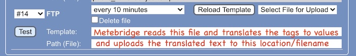

A Meteobridge uses
  • a template-file with "tags"
  • to generate a file with "values"
  • and upload that file with a name to the specified server.
File-names are just names , the contents of your two files have a different layout => so the contents of the template files are different.

Thanks Wim, but both GUIs are different. In the wrong version i miss a field "select file for upload" and ín the "good one" I can choose the realtime.txt file.
Re: software difference realtime.txt
Ger wrote: Mon Jun 29, 2020 1:43 pm Thanks Wim, but both GUIs are different. In the wrong version i miss a field "select file for upload" and ín the "good one" I can choose the realtime.txt file.
In both versions you can set the link from the browser with which you tested first if that template-file is correct.
On a Nano/Pro you can store the template-file also on you local MB-disk, but wait with that for now.
It is easier testing to store the correct template file on one of your websites., give if a new name also f.i. "templ_rt_20200629.txt"
And use the same link with both MB's
If all is well and the both MB's are uploading correct translated files => then you copy the template file to your Nano
Keep the new name, otherwise make sure that that file-name is not used by some other script such as the built in Nano-weather34 dashboard
You then always have a backup of the template file, 1 is stored on your nano, the other one is stored on your website for the other MB
Sounds like you have a PRO or NANO SD (with the upload-selection drop-down) and another type of Meteobridge without local storage and without the drop-down option.

Thanks, that means that I not can use another file?
On non PRO or NANO SD you dont have any files on the Meteobridge. They need to be provided from a HTTP source.
