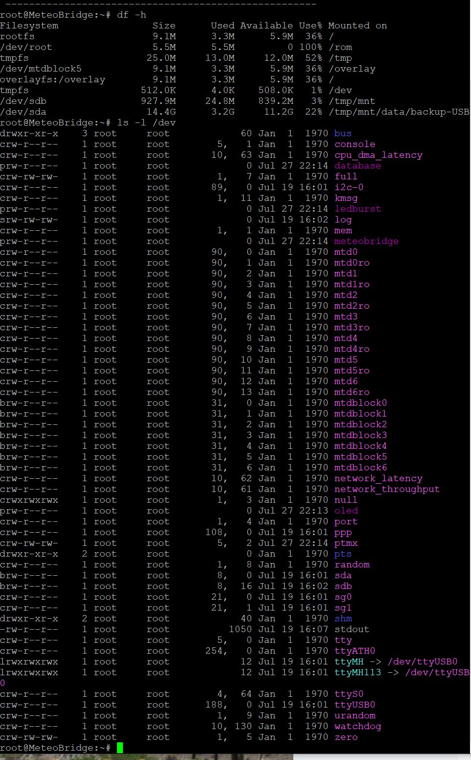

Did you check on the OS level if the stick is recognized ?
I don't have any special stick and so far my MB Pro recognized them all, even an external 160 GB hard disk.
Connect with puTTY via SSH to the MB Pro and then check if it is recognized.
PuTTY can be downloaded from the web if you don't have it.
You have to enter the IP address of the MB Pro in your LAN in order to connect (use SSH protocol via port 22).
Use the username and password you also use for the web interface.
I guess you first have to connect the USB stick and then reboot for the OS to recognize the stick - not sure if the mini-Linux can dynamically recognize devices.
with the command
"df -h" (without the "")
you will get all mounted storage devices shown (that's the storage which can be used by the operation system) - you can usually tell by the size/capacity which is your USB stick. See top portion of the picture.
The internal USB has 927.9 MB, my external USB stick has 16 GB capacity (the OS recognizes 14.4 GB).
My external USB stick is mounted into a folder/directory which I created as a subfolder of the /tmp/mnt/data folder in order to be able to see it in the METEOBRIDGE network drive (mount) under windows. I have given it the name "backup-USB". That's just for explanation in case you wonder what that path behind my /dev/sda is about.
The name of the device should be sda, sdb, sda1, or sdb1.
Which devices are available you can see with the command:
"ls -l /dev" (which lists all the devices in the device folder /dev)
in my case the internal USB is "sdb" and my external USB is "sda" - but this sometimes changes after reboots.
Linux identifies the sticks as SCSI drives: SCSI drive a (first drive) which translates into "sda". If the drive has more than one partition, it adds "1", "2", "3" to it, e.g. sda1, sda2 ....
For a backup USB stick you would normally have only one partition, therefore it is very likely that your external USB stick will be either sda or sdb.
If you USB stick is either sda or sdb and not sda1 or sdb1, you will have to edit the backup script as the the script expects a device with the name sdx1 (x=a, b, c....). That might already be the reason why your backup doesn't work (I had the same issue, as my device name changed from sdb1 to sda). And you will have to save your backup script externally as with every reboot the script backup.sh is overwritten with the delivery version and then replace it again! Usually (but not always) it is enough to have a renamed copy in the /data/scripts directory, e.g. backup_mod.sh.
Sometimes, I think it comes with every program update, the whole directory is purged. Therefore the external copy.
There should be two sdx devices visible if you have inserted one external USB drive/stick. (x=a, b)
Can you verify how many you find/see ?
Then we can take it from there ....

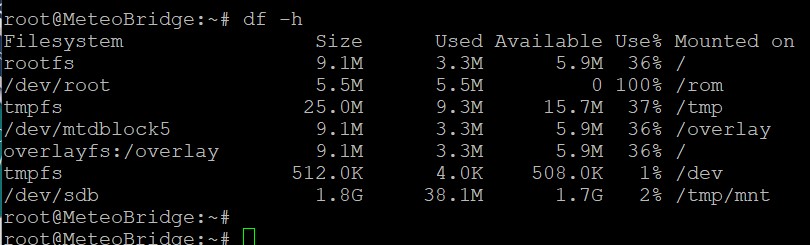

zmcreynolds4
- Fresh Boarder
- Posts: 7
- Joined: Mon Jan 29, 2018 6:10 pm
Re: MB Pro not recognizing USB stick
Thank you for the very rapid and extremely helpful reply.
I read your post carefully, dug a little more deeply into my system using Putty, and it is working now as expected. Of note, you do not need to reboot the MB for it to recognize the stick it appears since I added a stick to the back port and it came up without a reboot.
Your advice solved the problem. I simply changed the line in the script file to read as follows after determining the correct location:
TARGET = "/dev/sdb"
Thank you!
TARGET = "/dev/sdb"
Thank you!

Re: MB Pro not recognizing USB stick **solved**
It would be nice if it were as you write - but it isn't, and I have proof enough in logs etc. that it isn't.
Currently my USB stick keeps on appearing as /dev/sdc1 - and neither as sda1 nor sdb1 as it should following your post above,
and I haven't found out yet why (sometimes, rarely) it shows even as a /dev/sdb or /dev/sdc.
And it's always a stick with FAT32 and one partition only.
It shows as /dev/sda1 when inserted before booting, correct - but when inserted later, it's not always /dev/sdb1.
But your backup script covers for that as it asks for /dev/sd?1.
So all is fine as long as the USB stick is recognized by Linux as sd?1 (but sometimes it isn't).
Why to insert it later ? Because the OS of my MB Pro sometimes "forgets" the USB stick - again no clue why?
Pulling and re-inserting it makes it work again.
So the only solution is then to reboot when your Linux doesn't behave properly and shows the stick as /sdb or /sdc ???
(what it does at times - I notice that as my backups fail then, as the backup script doesn't recognize devices with a missing "1" in the end)
