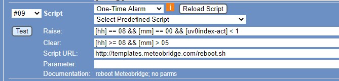

Here you go, this should do it:
Script Execution - One-Time Alarm
Select Predefined Script -> Reboot
Raise: [hh] == 08 && [mm] == 00 && [uv0index-act] < 1
Clear: [hh] >= 08 && [mm] > 05
Script URL: http://templates.meteobridge.com/reboot.sh
MB Reboot if UV low.jpg (36.05 KiB) Viewed 14957 times
Meteobridge RPI | GW1000
