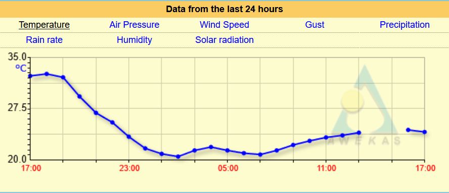

I also received that mail (28.07.2020 13:11 local time).
Meanwhile everything is working again, but in my AWEKAS graph there is a 3 hour gap.
I didn't change anything still running on the 13-July release.

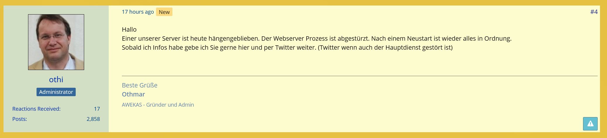

FYI
AWEKAS founder and admin gives a statement as a reply to questions regarding the outage in their forum:
https://www.awekas.at/for2/index.php?th ... g-offline/
For those who don't understand [Austrian 8)] German:
"One of our servers got stuck today. The web server process crashed. After restart everything is okay again.
As soon as I have further information, I'm pleased to share this here and on Twitter. (Twitter then when the main service is not working)."
So far no further statement.
