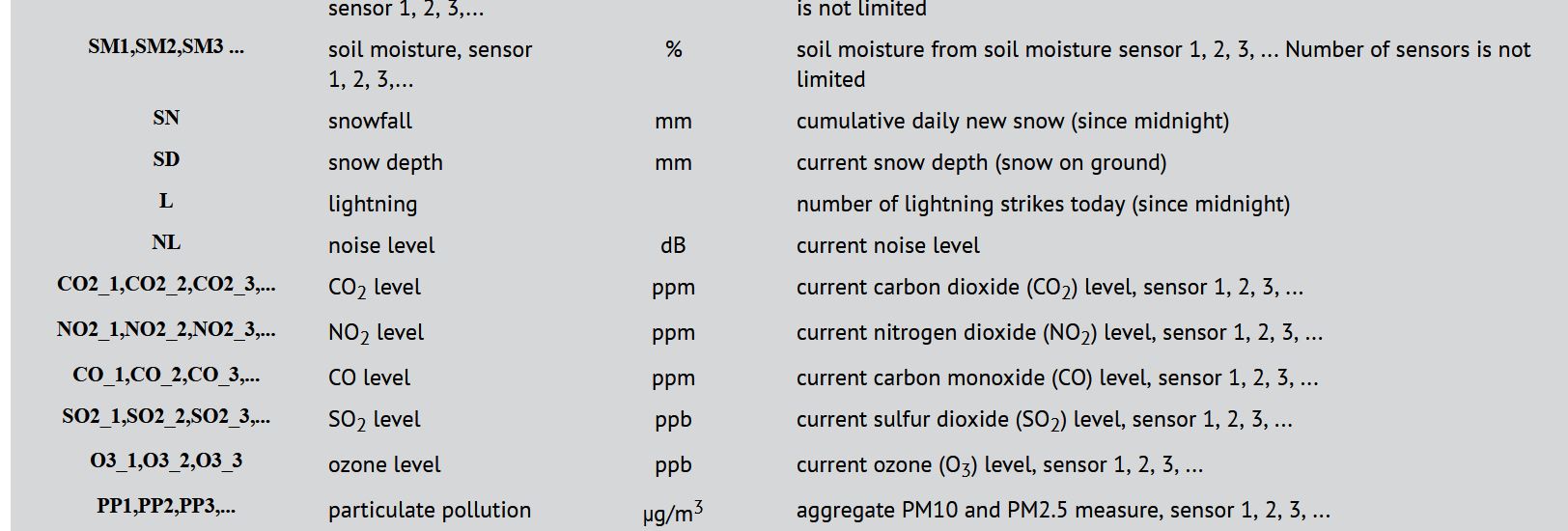

The Meteotemplate-API provides for 4 Soil-Moisture (default), 1 Lightning and 4 particulate matter (PM2.5 or PM10) sensor values.

4 Soil-Moisture (as per Meteotemplate API description the number of sensors is not limited here, but MB sent only 4)
1 PM2.5 (should be 2 and 4 could be sent in the standard/default database definition; MB just sends one)
0 Lightning (where meteotemplate expects the strikes per day; MB sends nothing, no value with the header L: to be found).
=> Meteobridge doesn't send data of the 2nd (or more) PM2.5, noned of the one and only lightning sensor value(s) and not more than 4 Soil moisture sensor data values.
The missing sensors should be included in the upload definition/script/... at the MB side.

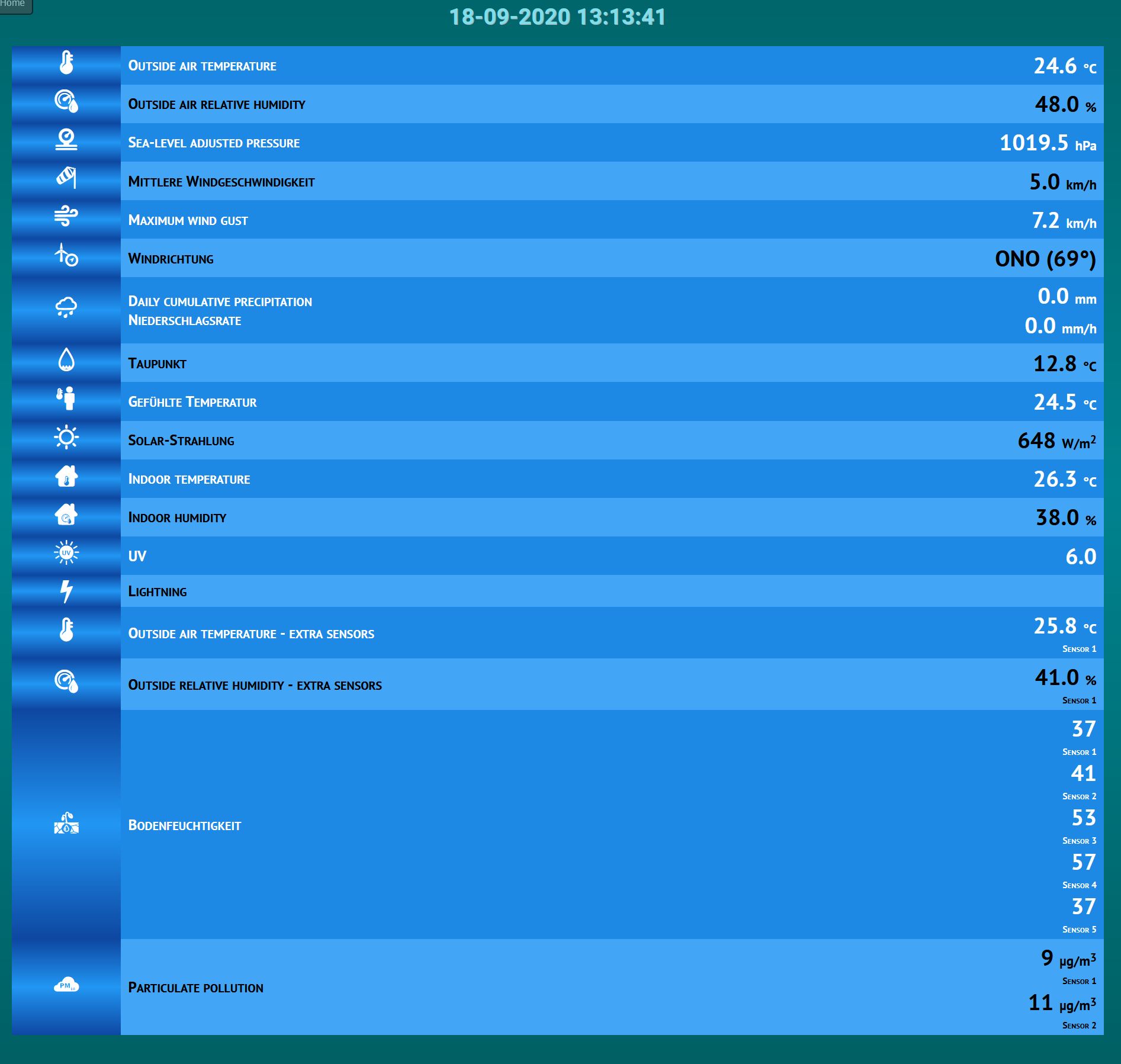

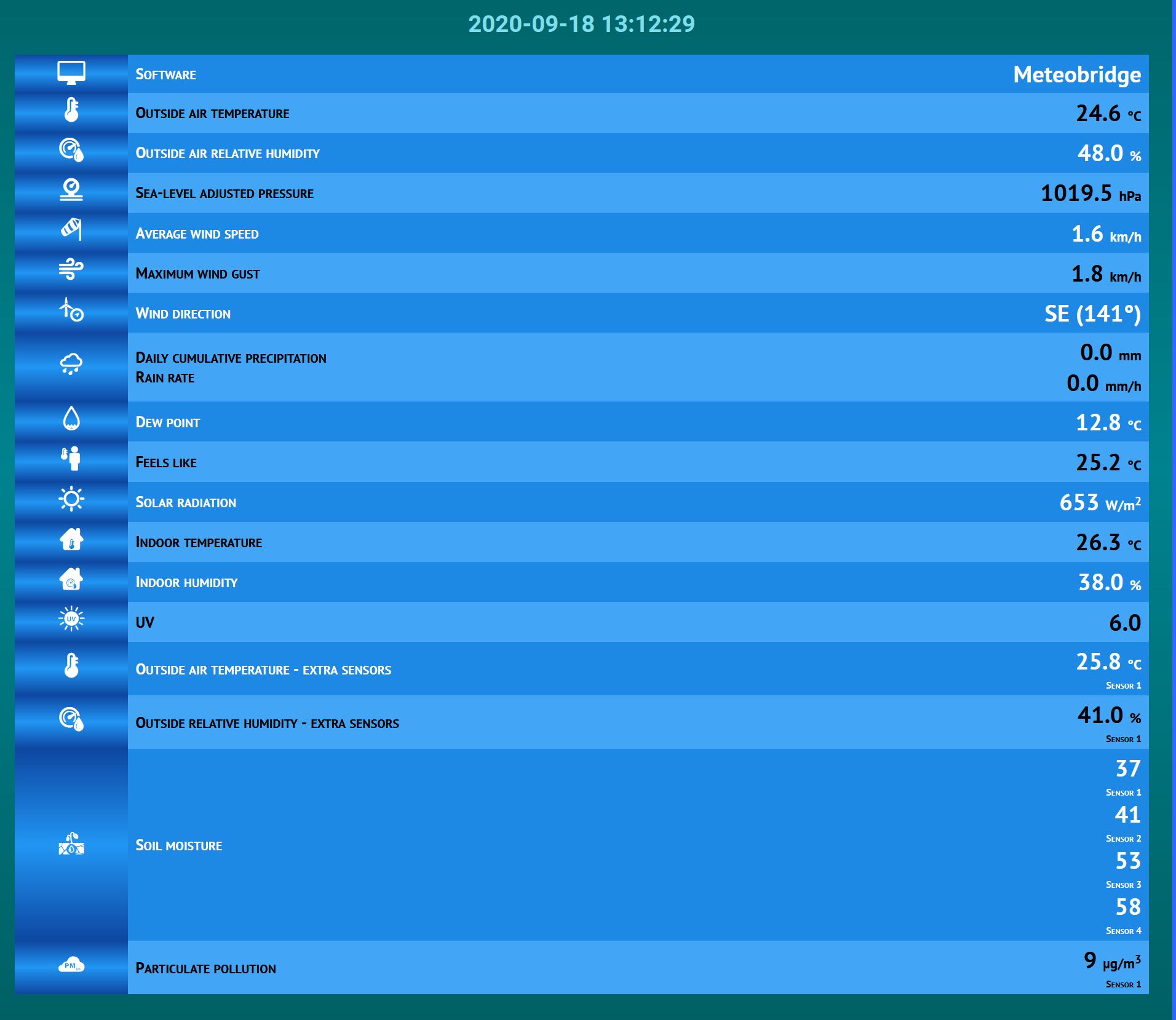

The inbuilt Weather-Netupload for meteotemplate is still faulty/incomplete - still only 4 Soil-Moisture and only 1 PM2.5 and no lightning sensor values posted. In the live data and history these sensor data are available, but they are probably missing in the upload string (call of the meteotemplate api.php)
That's what is sent by MB-Pro:
and this it what should be sent (my own http call as nothing is moving at this front here):

@anybody else using meteotemplate and want to have more than 1 PM2.5, more than 4 Soil Moisture sensors and at least one of the lightning values stored in the meteotemplate database:
http://YOUR-SITE/yourpath-to-the-templa ... api.php?U=[epoch.1:]&T=[th0temp-lastval.1:]&TMX=[th0temp-max5:]&TMN=[th0temp-min5:]&H=[th0hum-lastval.1:]&P=[thb0seapress-lastval:1]&W=[wind0avgwind-lastval=kmh:1]&G=[wind0wind-lastval=kmh:1]&B=[wind0dir-lastval:1]&R=[rain0total-daysum:--]&RR=[rain0rate-lastval:1]&S=[sol0rad-lastval:2]&UV=[uv0index-lastval:1]&TIN=[thb0temp-lastval.1:]&HIN=[thb0hum-lastval.1:]&T1=[th1temp-lastval.1:]&H1=[th1hum-lastval.1:]&SM1=[th20hum-lastval.0:]&SM2=[th21hum-lastval.0:]&SM3=[th22hum-lastval.0:]&SM4=[th23hum-lastval.0:]&SM5=[th24hum-lastval.0:]&L=[lgt0energy-lastval.0:]&PP1=[air0pm-lastval:2]&PP2=[air1pm-lastval:2]&PASS=yourpassword
