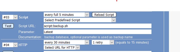

I have inserted a USB Stick into the front for backups
I have also set up a service as shown

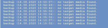

I get the following error
Any idea what might be wrong

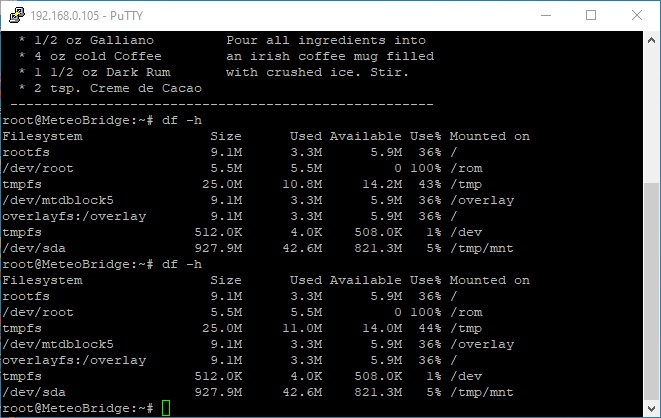

Logged in using Putty this is what I see
My USB drive is 8Gb and I dont think it is showing

I cannot get my Pro Red to see either the front or rear USB devices
They dont show when I do df -h
Am I missing something here ?

I have created the service as shown but still getting no target media found
