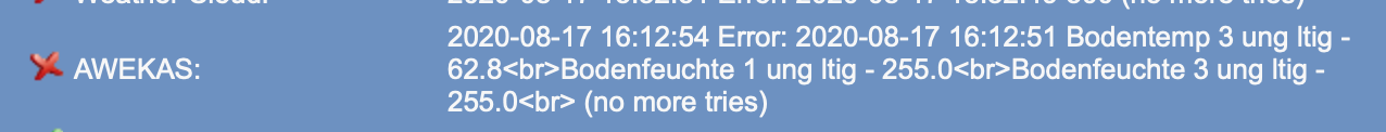

With the newest Meteobridge NANO SD Firmware some error-message at the AWEKAS-Upload appears:
The first Soiltemp-Sensor for temp in 5cm height over the ground has no soil-humidity-sensor, so the hum-value is set to 255 from meteobridge, also the hum-value of the 3rd sensor.
I have one of the Soil-Temp-Sensors (sensor 3) in use as a rain-detector, the pseudo-temperature of 62°C stands for "no rain", temperatures over 70°C stands for rain. It seems so, AWEKAS don't accept this high values?
A disabling of the SoilTemp/Humidity-Sensors in the Station-settings on AWEKAS don't solve the problem.
Despite the error-message, the other weather-data transmitted to AWEKAS .
Can I do something to prevent the error-Message?

Just released update does suppress any moisture reportings, when value is 255. Hopefully that at least partly solves the issue.

Error-message reduced: only one Soiltemp-Sensor are marked as errorous (Sensor 3, my rain-detector as described in my previous post), the 255er soil moisture-values are not more marked.
On AWEKAS, no Soil-Temperatures or Soil-Humidity are displayed, I have never seen it on any station.. ,would it be possible to remove the Soiltemp-/hum completely from the MeteoBridge-to-AWEKAS protocol? In my opinion there is no reason to transmit it to AWEKAS.

Since the newest Update from 18.Aug.20 the error-message in send-status from AWEKAS is gone!
The possibility since this update to calibrate all Meteobridge-sensors is a great feature, thank you very much for it!
