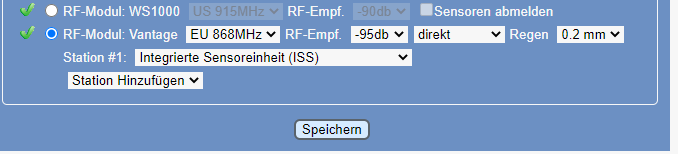

The distance is about 60m with an signal strength of -60 / -80 dB. Same Issue with direct connection via console.

Did changing RF sensitivity to -80db solve the issue (which to my experience would do)?

Why -80db, could you explain please? I will test it.
Re: Meteobridge PRO spontaneously stops transmitting data
-95db might catch too much rf noise so that the receiver is "blinded".
