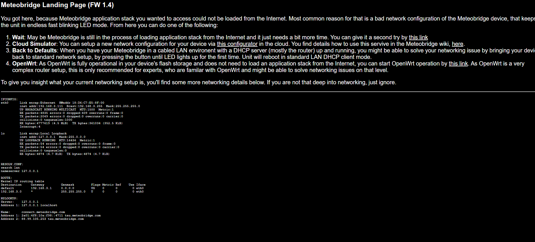

I have issue landing meteobridge web interface (TPlink MR 3020). I got the error Black screen message. I have tried with static IP as well. tried different location, reset the meteobridge but still getting the same issue. Tried open wrt also but couldn't land the meteobridge landing page. I am in a enterprise environment and i connected meteobridge with switch. Couldn't land into the meteobridge page. I actually need this sorted to pull the data Davis vantage Pro 2 weather station to our intranet site. Can you share some suggestions. Thanks

I would guess it has something to do with your enterprise environment? Firewall restrictions? The MBPro can't see the outside world?

From looking at your black screen boot up Landing Page I see the following:
RESOLV.CONF:
search lan
nameserver 127.0.0.1
NSLOOKUP:
Server: 127.0.0.1
That to me looks like a problem because the Meteobridge did not find your DNS server on your network. It pulled an IP address of 192.168.3.111 but no DNS or maybe you set it as static IP and didn't enter in a DNS server address? 127.0.0.1 signifies itself as a DNS server...as that is the reserved address for local loopback. The Meteobridge is not the DNS server. If you are configuring manually with static IP then I suggest using 8.8.8.8 as your DNS server if your network allows that. If not you can try your gateway 192.168.3.1 or maybe look at a different computer on the network to see its network configuration to see what DNS server is available on your network.
