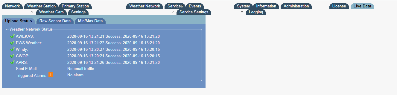

Looks like the GUI has issue now. Tested on two independent browsers.
amateurextra
- Fresh Boarder
- Posts: 8
- Joined: Tue May 28, 2019 2:10 pm
Re: Multi-Station Feature released today
I am having the same issues with the new GUI. I tested on Firefox and MS Edge, both current versions and both display the same GUI. Screen shot is attached
- Screenshot_2020-09-16 Meteobridge(1).png (28.02 KiB) Viewed 6390 times
Problem is solved with just released update. The corresponding changes in the css file didn't make it into the previous release. Small thing but really looks odd
