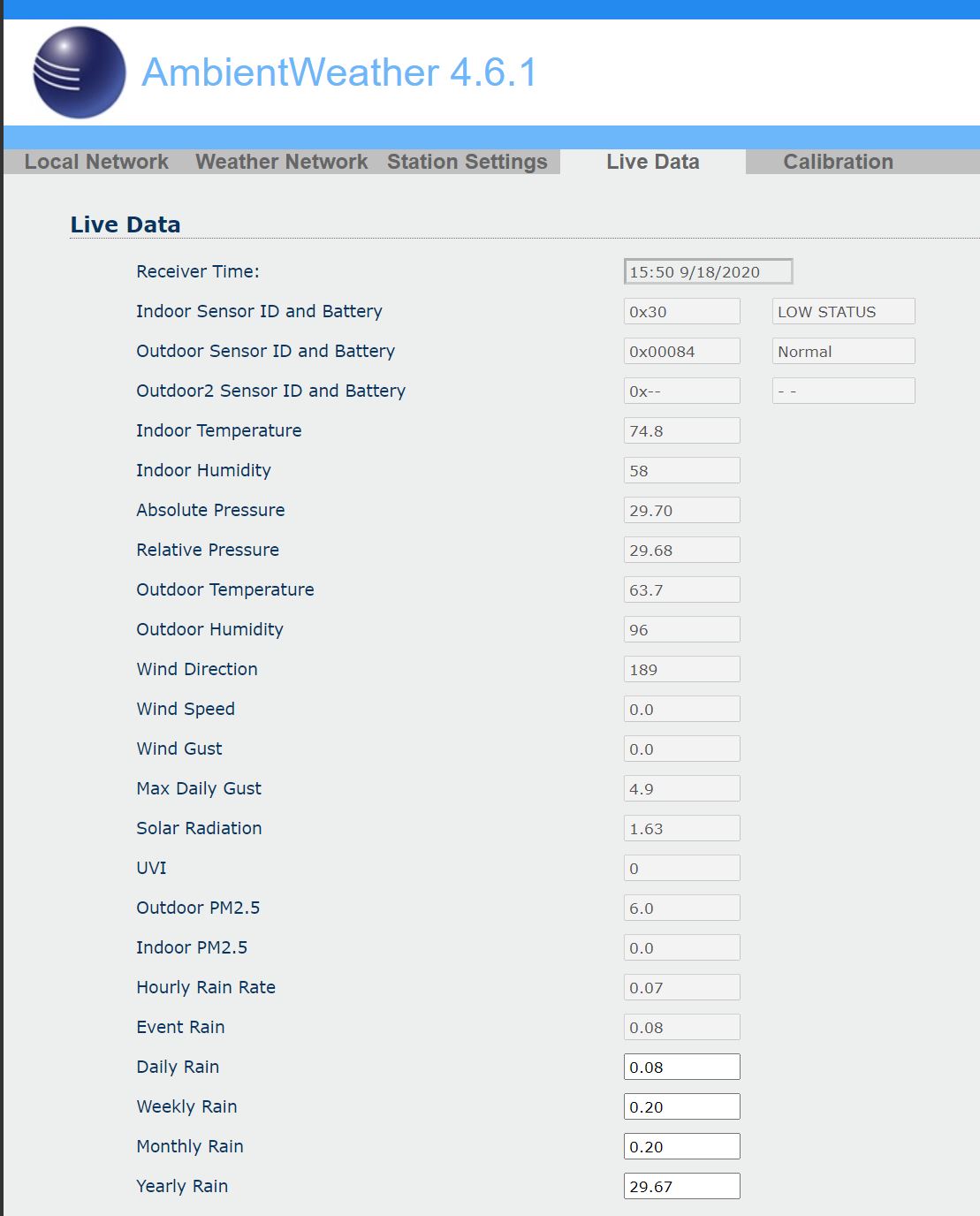

I purchased an Ambient Weather PM 2.5 sensor that I'm trying to log with Meteobridge and my Observer IP. I can see the sensor on the Observer IP's webpage:

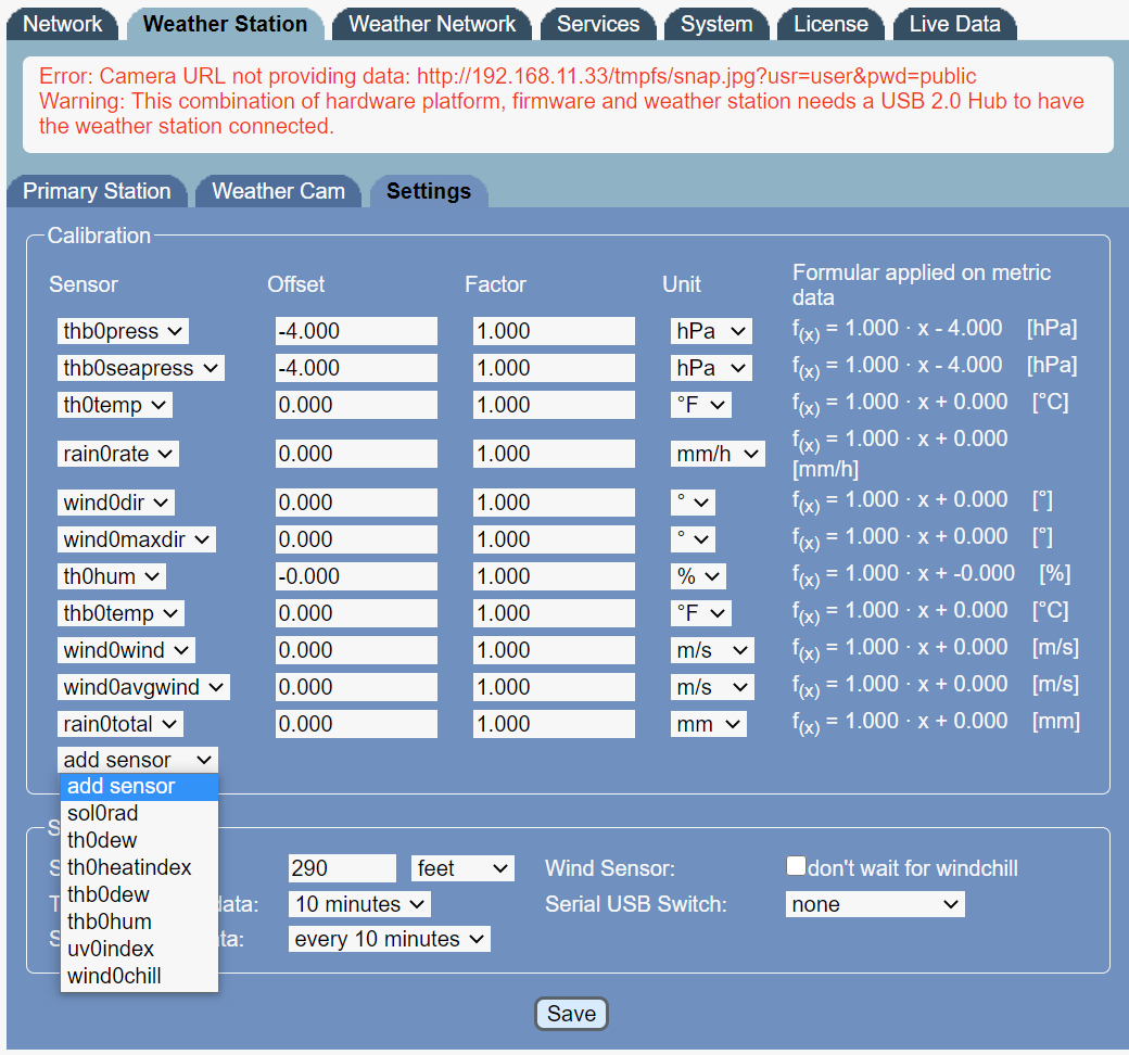

However, I don't see how to add it to logging on the Meteobridge interface:
Is there somewhere else in the new interface that I need to add the sensor?

Adding sensor on calibration screen just adds calibration options for existing sensors. You cannot define new sensors there. This is a funny try :-)
Currently the ObserverIP implementation is not supporting air quality sensors. To add this I will need remote access to a Meteobridge that has one connected. If you want to grant me remote access, please read the FAQ how to setup and send URL and password to info(at)meteobridge.com.

Hopefully this will help adjust your parsing script. I believe that they added a second PM2.5 (indoor) in the most recent release of the Observer IP firmware. Maybe that is causing this issue?
Re: Meteobridge 4.4 (Sep 17 2020, build 13754) on Observer IP PM2.5 Sensor
Thanks, it is as expected. They invented new names "pm25in" and "pm25out" :-)
<tr> <td bgcolor="#EDEFEF"><div class="item_1">Outdoor PM2.5</div></td> <td bgcolor="#EDEFEF"><input name="pm25out" disabled="disabled" type="text" class="item_2" style="WIDTH: 80px" value="6.0" maxlength="8" /></td> </tr> <tr> <td bgcolor="#EDEFEF"><div class="item_1">Indoor PM2.5</div></td> <td bgcolor="#EDEFEF"><input name="pm25in" disabled="disabled" type="text" class="item_2" style="WIDTH: 80px" value="0.0" maxlength="8" /></td>

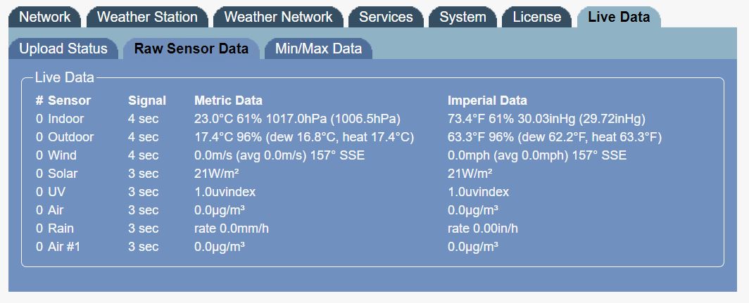

We're getting closer. I can see the fields now, but I'm getting 0's for the value. Perhaps a value field parsing issue?
I'm currently only using the "pm25out" device, which in the Observer IP's interface reports currently as a value of 6.0. Meteobridge "Raw Sensor Data" tab is reporting 0.0 for both "Air" and "Air #1".
