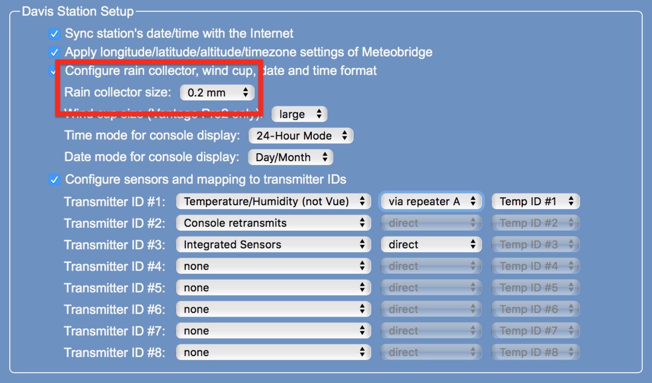

The setup screens are constantly changing.
https://www.meteobridge.com/wiki/index. ... ct_Station
As there is no console to read from, you have to tell the MB-pro-RED what the device is measuring.
Set it to the same settings as you did with your console.
Check https://www.meteobridge.com/wiki/index. ... ct_Station

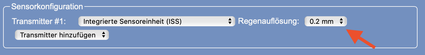

This is how it looks like for me (see screenshot). There you can see, 0.2 mm is already set (which is what the station is measuring). There are no further settings as the MB PRO receives directly from the ISS.

Re: Strange metric precip readings (0.3mm)!
should be solved with todays update. Please reboot and give it a try.

I did a reboot around 8 hours ago, now the readings are in 0.1mm tips instead of 0.2 mm... have you changed it again to the correct 0.2 mm since my last reboot?
yes, a reboot should fix this.
