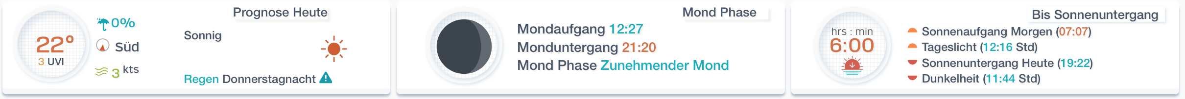

1. the WU forecast = I use exactly the same WU-API-Key as I do for my webspace-based W34-Dashboard, the forecast on the MB-Based Dashboard is still different.. First picture: web based W34- Dashboard -> all data seems to be correct

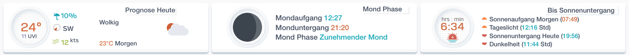

Second picture new local based W34-Dashboard -> The WU-forecast data and Sunrise/Sunset-Data are incorrect

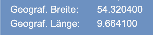

The sunrise/sunset-times on the MB-Dashboard differs from the times on the webspace-based Dashboard. MB is configured to use the internal coordinates saved in MB, this coordinates are definitively correct.
Bildschirmfoto 2020-09-21 um 13.54.07.png (20.01 KiB) Viewed 2325 times
It seems so, the longitude/latitude-set is wrong on the MB-Based Dashboard-Setup. The latitude/longitude can't be set in the local-Dashboard-Version in opportunity to the web based Version. Which latitude-/longitudes are used in the local based version?

Lon/lat will be taken from settings defined on Meteobridge "System" tab. Latest version had a bug regarding this data transfer. Just released version should have this fixed.
