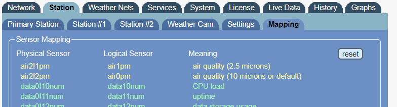

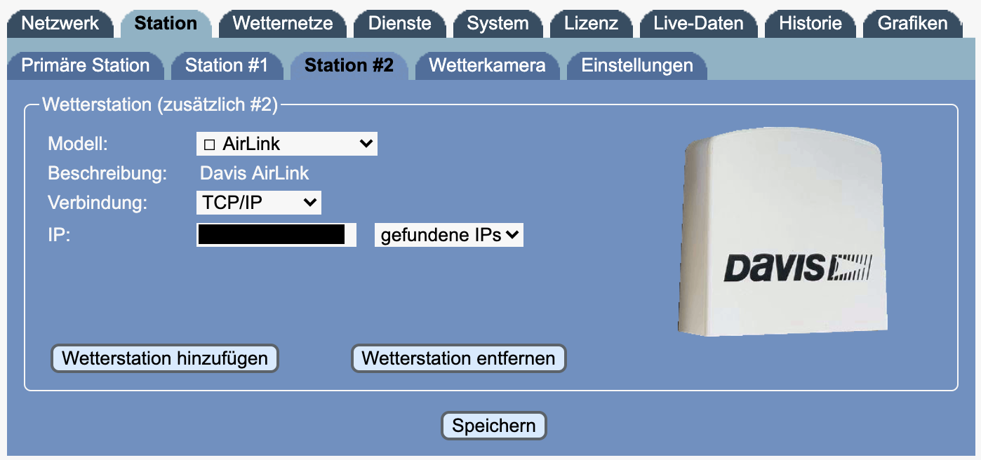

Post by thunderstorm »
I got my airlink today and added it as station #2 (#1 is my DYI particle sensor using a plugin).
I can access my airlink through the local IP (http://<ip>/v1/current_conditions), but my nano-sd is not showing any values from the airlink.
I tried the poor men's fix and rebooted my nano-sd, but no success.
Anything I can do to check or any idea how I can get it working ?
Screenshot 2020-09-24 at 16.51.52.png (160.98 KiB) Viewed 5199 times
Screenshot 2020-09-24 at 16.53.17.png (135.84 KiB) Viewed 5199 times

Re: Integrating AirLink - no sensor data
When IP is correct it should work, at least it does for others.
If you send remote access credentials to "info(at)meteobridge.com" I can have a closer look.

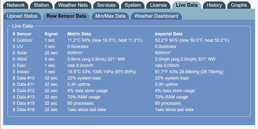

Screenshot 2020-09-28 092508.jpg (121.66 KiB) Viewed 5064 times

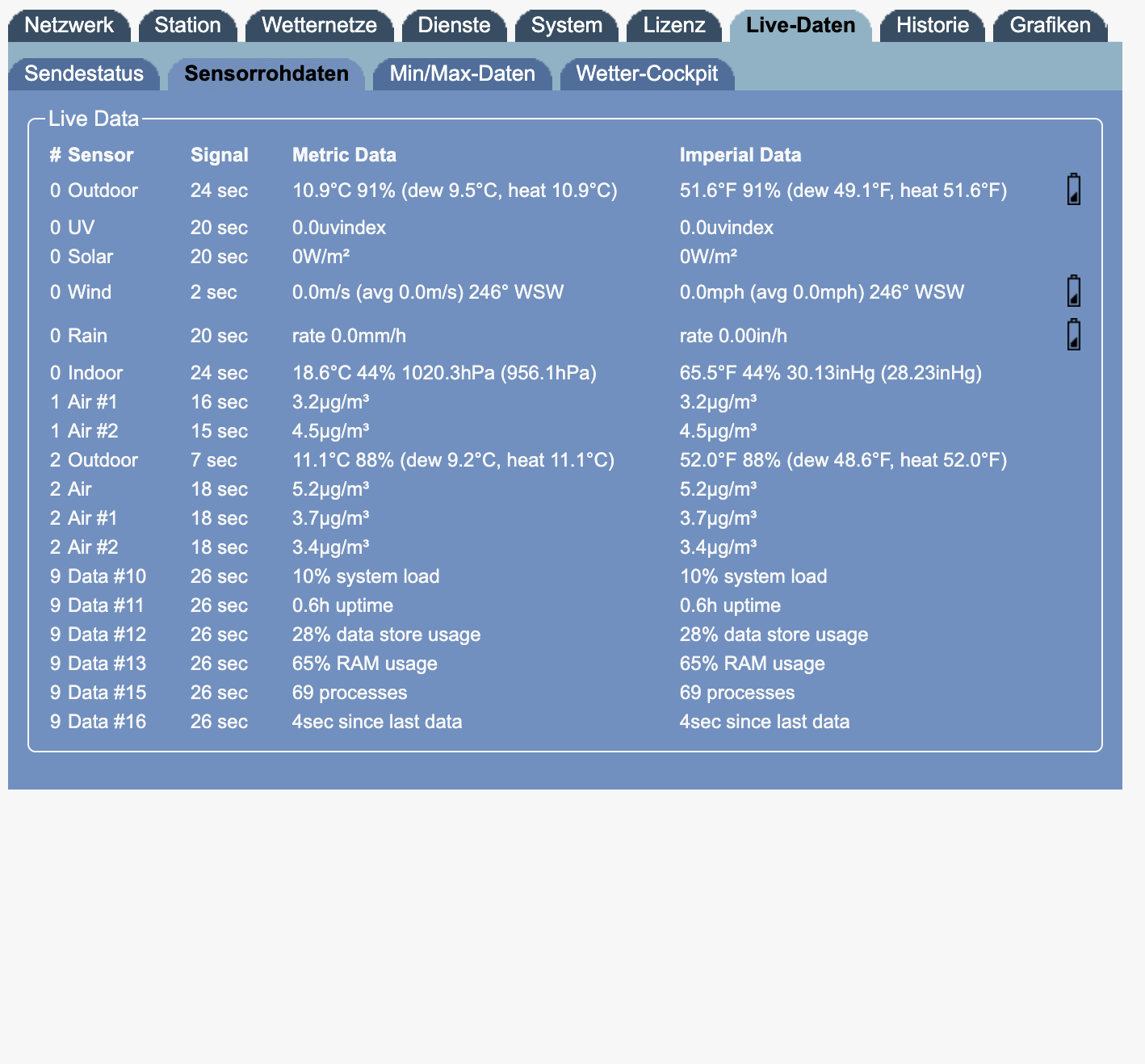

Seems to work with the Meteobridge 4.4 (Sep 29 2020, build 3407) release
Screenshot 2020-09-29 at 19.33.39.png (252.89 KiB) Viewed 5036 times
Thanks for fixing
Bernd
Screenshot 2020-09-29 130517.jpg (45.31 KiB) Viewed 5033 times
No joy on my end. I don't know if this version should be enumerating the new Station, but it doesn't seem to be doing so.

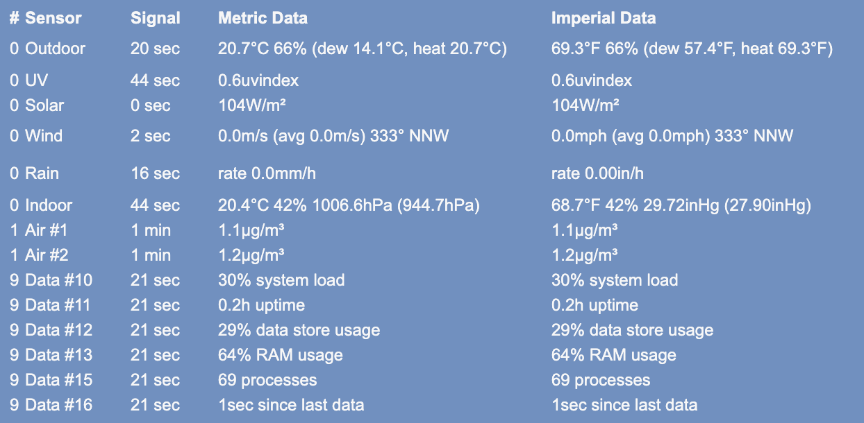

jasonmfarrow
Posts: 255
Post by jasonmfarrow »
The sensor is now collecting data. SW Version: Meteobridge 4.4 (Oct 2 2020, build 3436), FW 1.4
However the mapping of the Airlink physical sensors to the logical air quality sensor is the reverse of what I expected:
The Airlink has PM_1, PM_2.5 and PM_10 in that order but the logical has air0pm as PM_10, air1pm as PM_2.5 and air2pm as PM_1.
I'm hoping that this is as designed for some reason or are air0pm and air2pm logical sensor descriptions the wrong way round?
Like the others with a new Airlink i'm mostly getting zero values at present so it's difficult to tell, compared to the live data, where the truth lies.
{ "data": { "did": "001D0A100352", "name": "JMFweatherAQI", "ts": 1601650065, "conditions": [{ "lsid": 351579, "data_structure_type": 6, "temp": 69.1, "hum": 56.7, "dew_point": 53.1, "wet_bulb": 57.9, "heat_index": 68.3, "pm_1_last": 0, "pm_2p5_last": 0, "pm_10_last": 0, "pm_1": 0.00, "pm_2p5": 0.00, "pm_2p5_last_1_hour": 0.00, "pm_2p5_last_3_hours": 0.01, "pm_2p5_last_24_hours": 0.01, "pm_2p5_nowcast": 0.01, "pm_10": 0.10, "pm_10_last_1_hour": 0.10, "pm_10_last_3_hours": 0.15, "pm_10_last_24_hours": 0.15, "pm_10_nowcast": 0.13, "last_report_time": 1601650065, "pct_pm_data_last_1_hour": 100, "pct_pm_data_last_3_hours": 91, "pct_pm_data_nowcast": 22, "pct_pm_data_last_24_hours": 11 }] }, "error": null }
Jason
Assigning of sensors to air0pm to air2pm can be one way or another. I don't see a reason to change that to any personal preferences. How reliable this data from the Airlink is at all remains to be seen. The tons of zero measurements don't give me indication that these sensor comes any way close to professional measurement devices. Please don't blame Meteobridge for that.

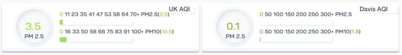

Not blaming you at all. Just asking for confirmation that the software is reading the Airlink PM values, PM_1.0, PM_2.5 and PM_10.0 and assigning them to airX!0pm, airX!1pm, airX!2pm respectively. That way we are sure that when we're mapping to logical sensors we're matching up correctly.
FYI. I think my Airlink is under-reading the PM levels compared to other sensors. Here's the comparison. My Nova SDS011 on the left and the Airlink on the right. The sensors are right next to each other and thus should be reading the same.
Screenshot 2020-10-03 at 3 October 2020 13.54.38 pm.png (80.61 KiB) Viewed 4945 times
PM2.5: SDS=3.5 vs AL=0.1 PM10: SDS=10.9 vs AirL=1.8. That's quite a difference by a factor of 10. My SDS011 values seem to be much more aligned to the wider airmass around where I live. https://aqicn.org/station/united-kingdo ... basings39/
The Airlink might be £179 of wasted cash...
