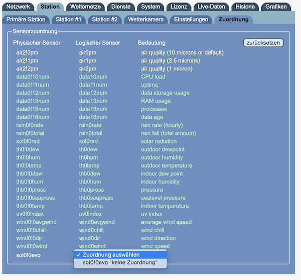

I'm aware that the mapping is still in beta, but I wanted to provide some feedback for the mapping flow.
It looks like some 'physical' sensors like solevo or heatindex don't have a logical sensor.
In the mapping page you can select them as physical sensor, but you can't map them to a logical one
Screenshot 2020-09-30 at 07.19.07.png (216.84 KiB) Viewed 1623 times
Not sure if you plan to provide logical sensors for solevo and heatindex as well, but maybe you could remove physical sensors from the mapping list if there's no logical equivalent.

Re: Beta Feedback: Sensor mapping
yes right, will be extended.
