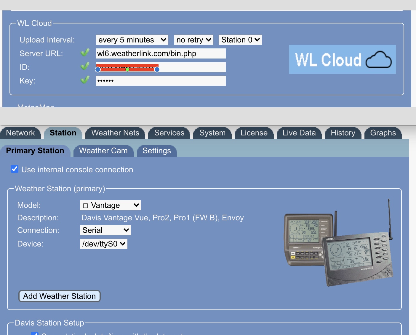

Re: Davis Weatherlink Cloud - access for Nano(SD)
My Nano already uploads for more then a year after the WLIP failed.
You need a valid DID (=mac address) but you can get one using weatherlink.exe and asking one with that program.
Then you setup the Meteobridge => tab Weather Nets => dropdown bottom last selection "Weatherlink Cloud"

Thank you. Using that Server URL made it all work instantly. Excellent!
