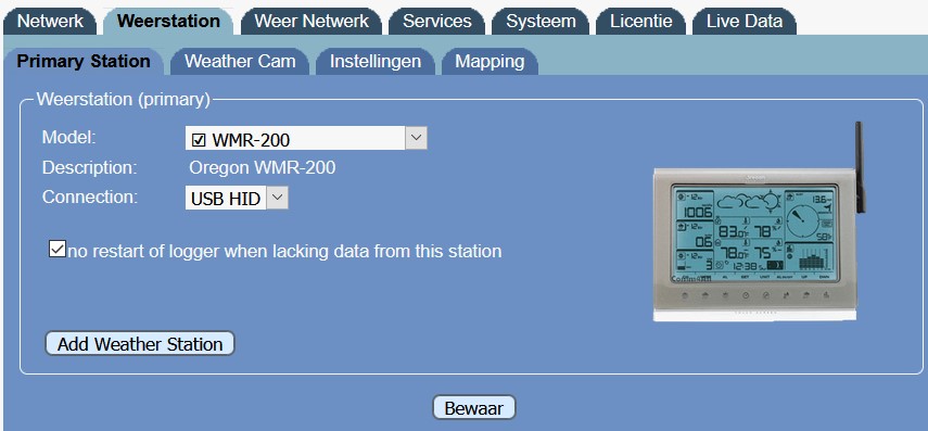

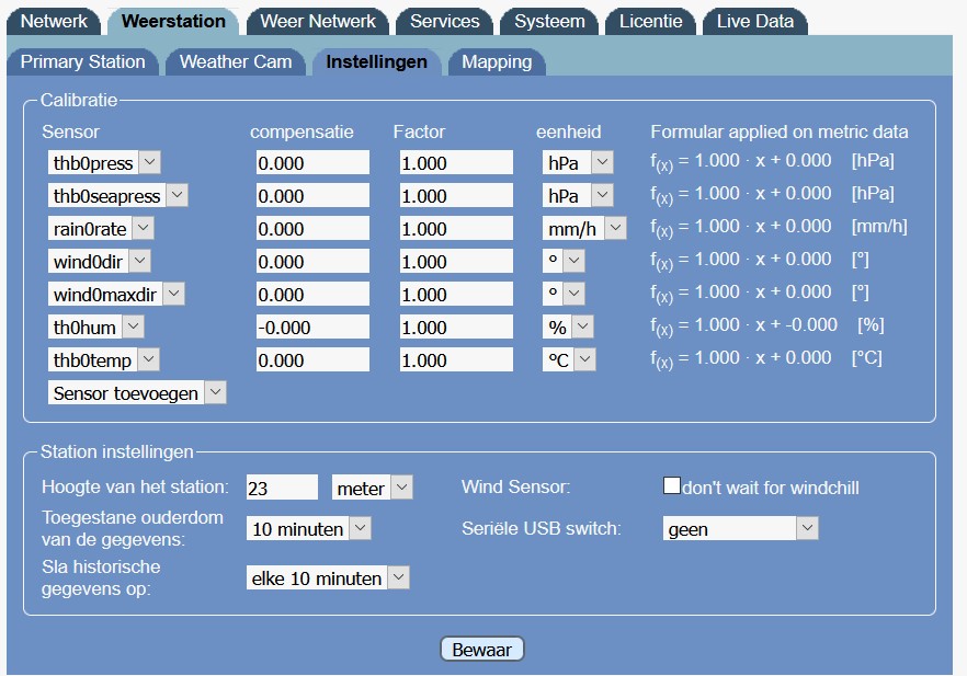

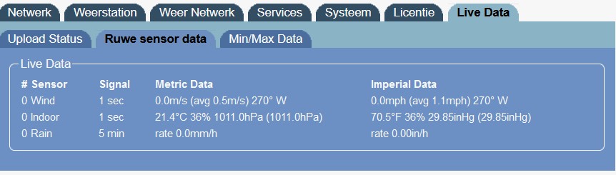

Post by martin »
it seems I have the same problem, meteobridge does not find the outdoor temp anymore.
I have tried serveral things like reboot, reset, reconect the temp sensor to the mwr200. changed the primary station, setup of sensors, mapping of the sensors.
The wmr200 displays the expected outdoor temp, meteo bridge doesn't. :(
Has anyone a clue whats going on, how to solve this issue.

Re: Outdoor Temp disappear after last soft upgrade - WMR200
Post by martin »
Hi Mirek,
you're welcome
The first time I remarked this issue was after a restart of meteobridge on october, 9th. Due to a power issue.
first I though, the issue was due a the power failure.
Last wednesday, I started to look more in detail to the problem. did some tests and reboots.
So it looks like the issue exists already before the 14th.
I have one outdoor temp sensor, it should be listed as th0temp (without the b, insite temp).
I've also send a mail to info@smartbedded.com this morning.
Martin
