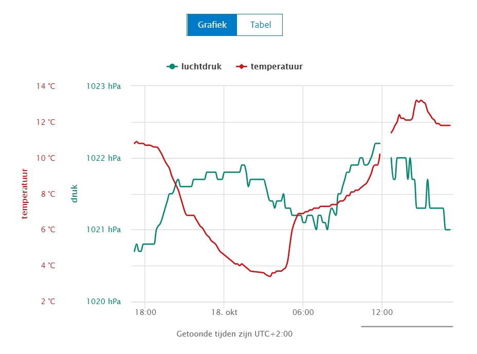

The interval of barometric pressure changed after changing to Meteobridge. It's about 0,3 hPa now, it was 0,1 hPa.
See also the difference in the attached image.
Is this a known issue? Or do I've to change some settings?

I believe that this is a limitation of feeding the Meteobridge with Imperial units, using inHg for pressure. Because 0.01 inHg corresponds to about 0.3 hPa. Therefore this isn't a limitation of the Meteobridge but rather a limitation of how you are passing data to the Meteobridge. See if you can change your logger to feed the Meteobridge data using metric(hPa) for your barometric pressure.
FYI - This has nothing to do with how you choose to display your pressure on the Meteobridge. Even if you choose to display hPa on the Meteobridge it will not fix the problem. You have to go to your logger as that is the source of the loss of precision.
